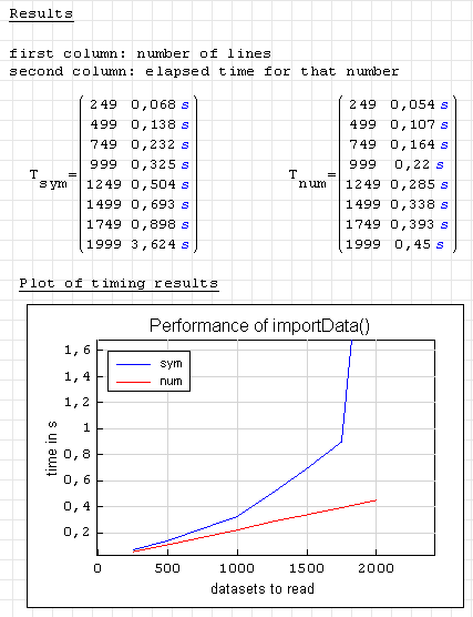

Thanks for the tips. The tips reduced the load/calculate times tremendously and now may be useful to me.
Edit:
So I just came across the snippets feature. I never knew this even existed sadly.
I've only seen an output from another company for CSC TEDDS. It was a concrete beam analysis and anchor rod analysis. I don't see why this couldn't be done in SMath. I'm someone who has created spreadsheets, Mathcad, and SMath (superior to Mathcad in my opinion) sheets without paying an arm and a leg to a company like CSC just to make it look "pretty".
Forgive me, but I'm not sure I understand what you are trying to accomplish as far as design checks. So when you select the material, do you want the same SMath sheet to perform the necessary design checks based on whatever material you choose? Or one SMath sheet for steel checks, another for concrete, etc, but each sheet will be similar in approach as far as organization of loads and import/export data?
I'm willing to help if I can understand the goal. I realize what you are trying to accomplish isn't the easiest thing to explain through text on a forum.
ioan92 and mkraska,
