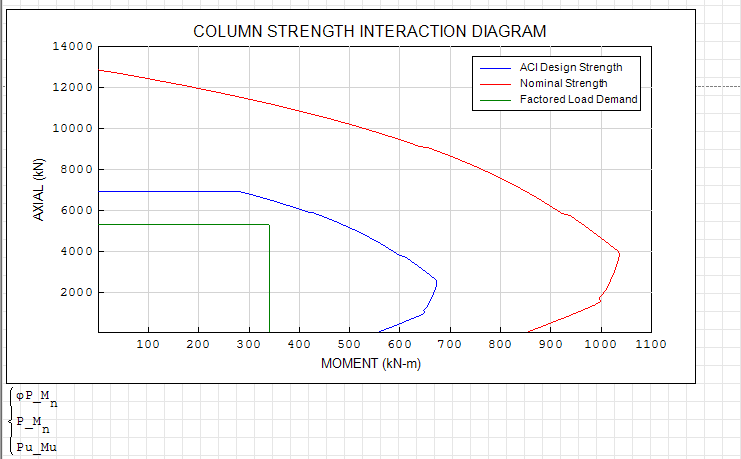

#1 Posted: 5/2/2015 4:16:28 AM
I've attached a file to generate the Compression and Bending Interaction diagram for rectangular sections, using ACI 318-11.
Any SI and US customary units work, but the results are in kN-m, which can be switched manually if you know where to look.
The rebar area and location column vectors can be made larger or smaller with no effect to the algorithm, So any number of steel layers can be used.
Future work: Expanding on this to include Biaxial Bending using the Reciprocal Load method. I had done this previously with MathCAD, and am currently working on a version for smath. I am having trouble getting it to be done without human input at certain points, but will keep working on it.
Please upload any improvements done to this file and post if any mistakes are found or if you have any suggestions.

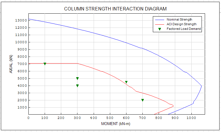

#3 Posted: 5/2/2015 10:10:03 AM
I have reproduced the diagram in Maxima Draw2D with automatic scaling (except for the x ticks, which are hardwired). Also, I parametrized the usage of units in the plot. One might even use radiobutton list regions for unit selection and having appropriate dynamic labels in the diagram.
P-M-Interaction_Kr.sm (182.88 KiB) downloaded 2150 time(s).

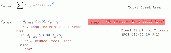

#10 Posted: 7/18/2019 10:59:52 AM
I need a compression and bending interaction diagram for my master's dissertation. I have downloaded the file and input the values of my column into the smath sheet. However. when i recalculate the page, it does not update the diagram.
How do i update the diagram to match up with my input data?
Any help would be appreciated.

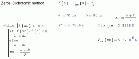

#13 Posted: 10/21/2019 1:47:56 AM
Hi.
The formulae for apply is valid only for certain ranges. You can see that the surface is outside the required range (by the norm), so, the SMath error actually is irrelevant: what it's important is the red in the worksheet:
Solvers are unstables, except maybe for al_nleqsolve. But here, and similar cases, you can implement always your own solver:
I have a question.
1) An error occurs when the length of the column becomes longer.
ex) hx = 4000 mm
2) I want to find n value that satisfies Pnx = pu.
when I use the solve() function, an error occurs.
Is there a way to fix it?
how can find n value ?
#14 Posted: 10/21/2019 9:24:53 AM
Wrotewhen Iuse the solve() function, an error occurs.Is there a way to fix it?
... more solvers in there.
Solve Dichotomy.sm (19.94 KiB) downloaded 1665 time(s).
Solve roots Newton-Raphson.sm (51.33 KiB) downloaded 1703 time(s).
Solve roots_solve RootSecant (1).sm (104.62 KiB) downloaded 1730 time(s).

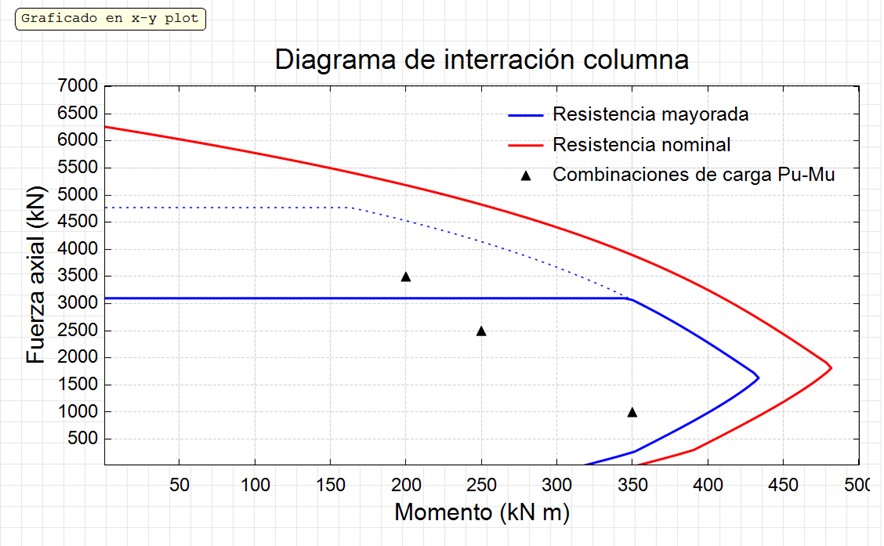

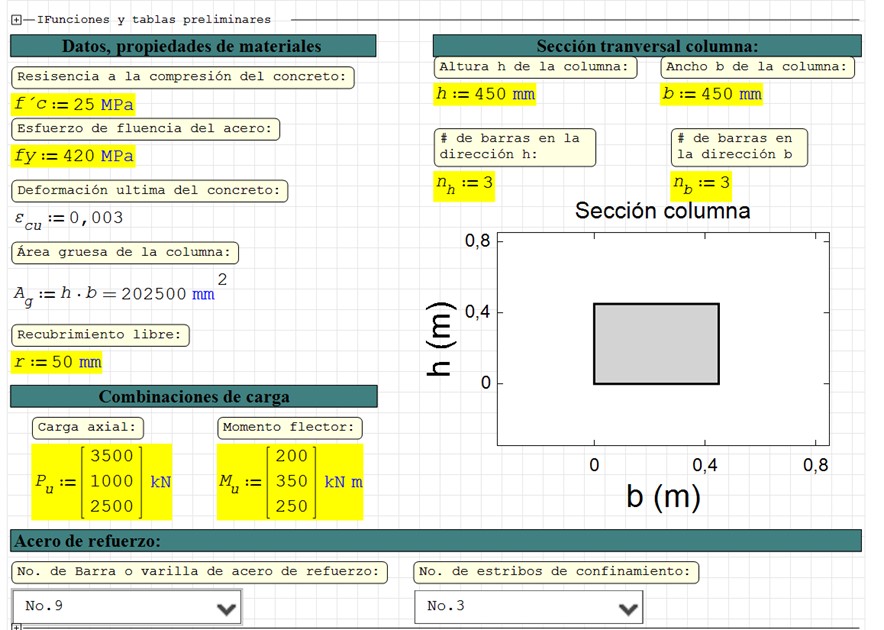

#16 Posted: 8/23/2023 10:45:53 PM
I had made my own code, but I was missing graphing, I took as a guide the code previously published here and additionally I added the graph the cross section of the column and the load combinations P-M, it would be missing to add the steel bars to that section to have a better graphical interface.
I will work to complement the code with bresler's reciprocal load method.
Diagrama de interaccion.sm (848.38 KiB) downloaded 1884 time(s).
