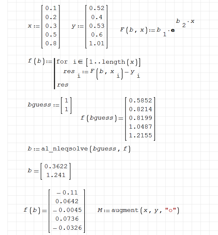

SMath Forum SMath Studio Samples Nonlinear curve fitting - example 1 Pages (2 items) Nonlinear curve fitting - example - using al_nleqsolve - Messages Go to last post #1 Posted: 4/20/2021 3:56:16 AM Radovan Omorjan 325 likes and 1 dislikes in 2,052 posts. Group: Moderator A simple example of curve fitting with al_nleqsolve().I hope someone will find it useful.Regards,Radovan nonlinfit.sm (8.74 KiB) downloaded 922 time(s). When Sisyphus climbed to the top of a hill, they said: "Wrong boulder!" 5 users liked this postFridel Selitsky 4/20/2021 4:31:00 AM, sergio 4/20/2021 5:13:00 AM, NDTM Amarasekera 4/20/2021 5:45:00 AM, Alvaro 4/20/2021 6:01:00 AM, Davide Carpi 4/20/2021 7:14:00 AM #2 Posted: 4/20/2021 11:41:55 AM Jean Giraud 983 likes in 6,866 posts. Group: User Genfit [Algo Minimize(al_nleqsolve Alco, Thurber)].sm (85.48 KiB) downloaded 794 time(s).I just posted this morning, but don't see ? 1 Pages (2 items) New Posts No New Posts
