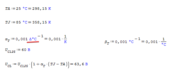

How to compute this
#6 Posted: 11/10/2020 12:20:49 PM
116 likes in 332 posts.
The problem is due to the internal storage of the program in Kelvin. You find several threads in the forum. you can also find an explanation in Martin Kraska's interactive guide (Tools menu -> Options -> Plugins -> interactive books). However the solution is to use DeltaC °
Davide Carpi 11/12/2020 10:10:00 AM
#7 Posted: 11/12/2020 9:04:06 AM
Int16
Int16
0 likes in 9 posts.
Thanks a lot.

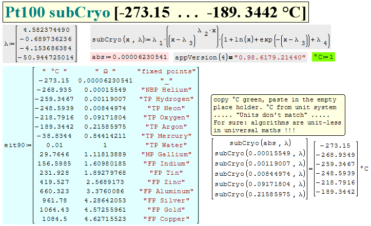

#8 Posted: 11/12/2020 10:30:53 AM
... you can make the unit system silent, i.e: inactive
#9 Posted: 11/13/2020 5:55:49 PM
1,303 likes in 2,218 posts.
This is close to recommending pencil and paper.
#10 Posted: 11/14/2020 8:49:14 AM
Pretty close Martin, that's ± what QA sanity check does.
The mV/I temperature converter reads mV ... then displays °C.
In parallel to the black box mV/I, read mV, interpolate wrt NBS [now NIST].
#11 Posted: 11/14/2020 2:24:48 PM
wrong display of output units
You will have infinitely many of those, easy to doctor:
1. make the system silent, though not quite paper/pencil
2. make it user style at will.
