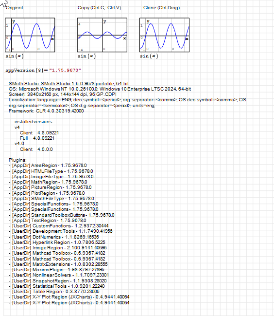

#6 Posted: 9/26/2026 9:14:26 PM
Hello Andey,
I can't reproduce the problem either. I used exactly the same portable version as in the above postings. The only difference I can see is the Framework version.

The screenshot shows the worksheet plot2d.sm as provided above.
I also tried some of the companion material of the book (which I had to save with version 1.4 in order to keep the plot ranges). I have no idea what could have triggered the reported behaviour of the plot region. The problem gave me a hard time in August, just 4 weeks ago and the workaround was to switch back to SMath 1.4. I didn't try to reproduce the problem since then (actually was using SMath only occasionally as a scratch pad).
Sorry for having created the noise. On the other side, I am happy that by whatever I seem to have gotten rid of the problem by now. I am not really "trusting the peace" as we say in Germany, but I keep fingers crossed.
