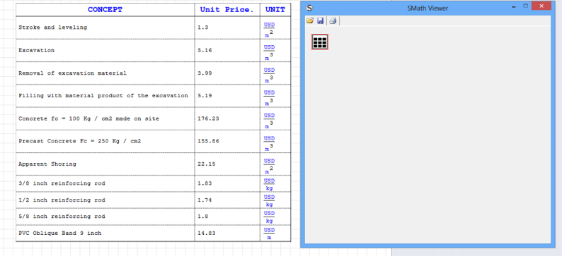

I found a way!
But it takes time depending on how many vectors you use.
I defined the single element indexes and gave them a name.

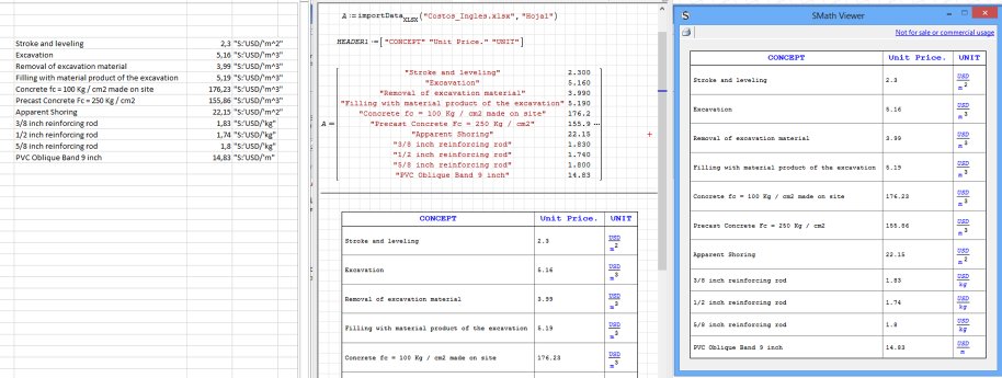

Hello G-Tate
I think it is better that you use Excel for data in the form of Vector or Matrix,
and then import them from SMathStudio, so that, the changes you make are saved in the Excel sheet
PruebaImport_Cost_English.zip (1.01 MiB) downloaded 618 time(s).
Carlos

Ok...but...
I think that the point is that in this way you neither can edit any value in the viewer...
In SmathViewer you can change the values of the variables, but it does not save any value,
that is, it remains the original value that was put in the SmathStudio
worksheet. SmathViewer is not persistent.
The idea of using it together with a spreadsheet (Excel or Libre Office) is in the
case of vectors or matrices with data that must be updated, without the need to
change the source code. For example for unit prices, so you do not have to type them every time.
Since from my point of view, the executable program of SmathViewer will be used
by a person who does not have access to the source code and who probably
does not know how to program, or who do not want to make changes to it. Otherwise,
if you have access to run the program in the source code (SmathStudio), what
sense would you have to use Smath Viewer?
SmathViewer needs to improve some functions, such as handling vectors and matrices, making persistent changes, etc.
Carlos

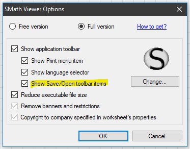

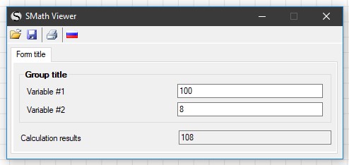

It is now possible to Save input data using Save dialog. It is also possible to load saved data using Open toolbar item afterwards - all saved values will be restored.
To enable Save/Open functionality an appropriate checkbox must be set to true during Save to *.exe:

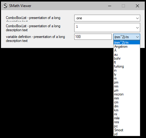

This is my first post here. I have been using SMath for several years, and also SMath Viewer for some time. I created a few simple programs to facilitate frequently performed activities. I'm a huge fan of the entire SMath suite. While working with SMath Viewer, I found a few small things that I think could be improved.

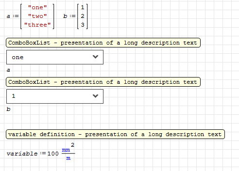

The first one probably does not relate to the SMath Viewer itself, but the ComboBoxList extension. The longer description of the list does not fit into the window, making it unreadable (as shown below). This happens when the list contains text elements. Working with numbers does not cause this problem.
The second problem relates to units. When a variable (or result) is in a non-standard unit (as shown below), the program gives the user a choice from the list to units that do not match the number completely. Incompatible units should not be proposed. It would be nice to be able to select the unit set when creating the EXE file. For example, I don't need imperial units in an EXE file.
Thank you for reporting the issue. It wasn't easy to find the cause but should be fixed now, I've released an updated plugin for the latest stable version of SMath Studio.
Thank you very much for this update. Now it works like a dream
