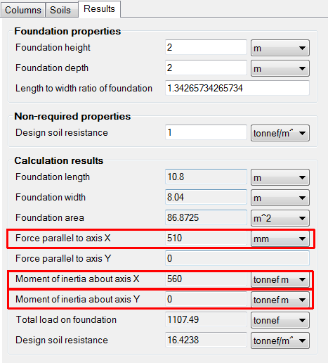

I am not from civil engng, however, it seams to be something incorrect in the TheFoundation.exe:
  1. Units for Force parallel to axis cannot be m or mm, rather Newtons
  2. Similarly, units for moment of inertia are (length)^4 (if the second moment is considered)

Thank you, IVR.
Example applications updated (generated using SMath Studio 0.96.4884).
  • Multi-languages feature enabled;
  • Executables size reduced;
  • TheFoundation application corrected.

The EmbeddedPlate might need a similar correction. Moment of inertia is of dimension length^4 (area times squared distance). Btw, how can I allow the user to switch between e.g. mm^4, cm^4 or inch^4?

I have also noted the problem with units changing in moment of inertia. It is, however, mostly academic problem. In practice, engineers are forced to use commonly accepted set of units. For example, stress in structures in SI-based countries is always in MPa.

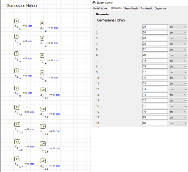

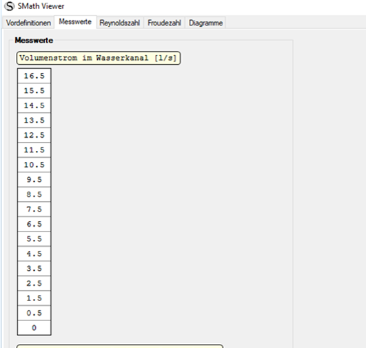

Hello there,
it seems that there is no possibility to use changeable vectors or matrices instead of single variables.
It is only possible to put vectors and matrices into a table and show the values in SMath Viewer without the possibility to change them.
Is there any possibility to use changeable vectors?
#20 Posted: 6/12/2019 12:02:58 PM
Gowand Gravi
Gowand Gravi
0 likes in 22 posts.
I found a way.
But it takes time depending on how many vectors you use.
I defined the single element indexes and gave them a name.
