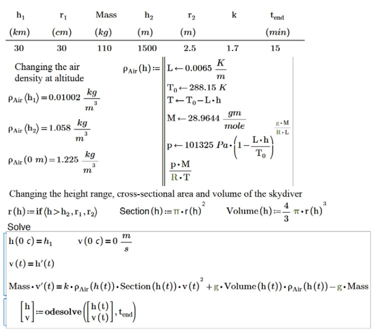

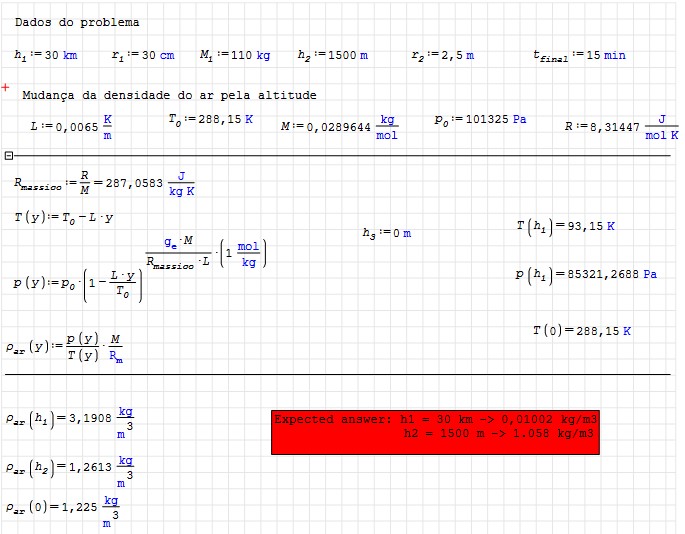

I've been following several posts for Q&A for some days about my doubts, but one about Units is not yet solved.
I've been trying to solve a simple problem for air density to practice.
The units always stand in my way and I am interested in how you guys would solve this: ignoring units and not using the built-in constants or make everything converted before handling the problem?
My sheet and the problem I'm trying to get the same results are in the images below.
Is there a way to make the function in a programming line ? Like the other software?
Couldn't get the answers by other's questionings.
Thanks in advance.

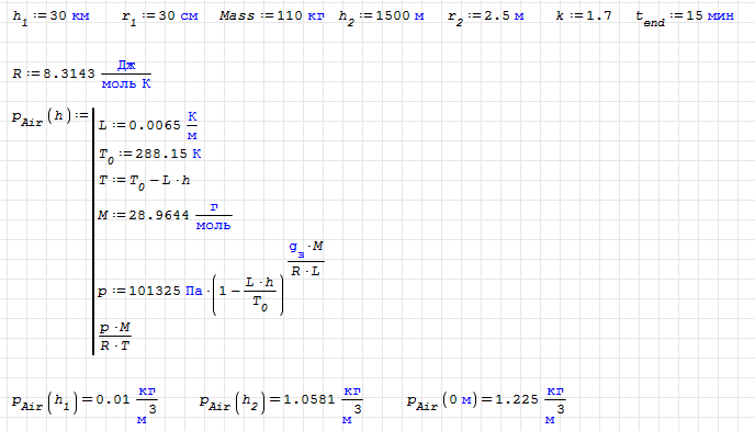

#2 Posted: 5/23/2019 4:18:03 PM
1,554 likes in 1,864 posts.
Try this.
Barometric formula.sm (9.31 KiB) downloaded 1057 time(s).

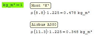

#6 Posted: 5/23/2019 7:36:46 PM
Just lost my long reply ...
The only possible programming line is the conditional .
NO software can't calculate otherwise than by segment
because Air is not an homogeneous media. So, NO single
formula, NO ODE can represent.
The attached will give you specific kg/m³ up to 85 km geopotential.
Naturally, don't put any units in there. Append unit in result.
Please don't hesitate for more Q & A
The 3 segments collected page 6/6
Inst_ISA.sm (138.45 KiB) downloaded 1019 time(s).

#9 Posted: 5/24/2019 12:22:17 AM
I'll study the document.
The J(x) upper segment was borrowed directly from Mathcad 11.
