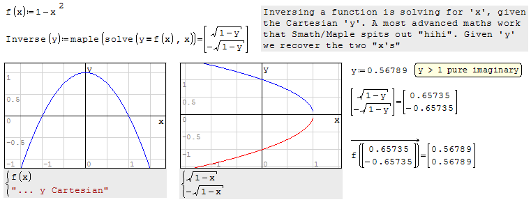

#7 Posted: 7/16/2019 10:33:16 PM
Revisit your example. The mechanics of Inversing a function is intuitive.
However the maths under the hood belongs to few advanced CAS [Maple World top].
Mathematica will do same, most of the times of different presentation.
Before you do anything with a function => graph.
Please, do not hesitate for more.
