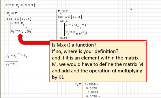

I wonder why left matrix give error and right is ok?

#2 Posted: 3/8/2018 2:21:56 PM
They are identical, but the left one is incompletely dressed.
I don't understand the project. There is nothing more confusing
than subscripts. They are useful if the subscript is a long explicative definition.
Test1(1).sm (59.42 KiB) downloaded 1210 time(s).
#3 Posted: 3/8/2018 5:46:08 PM

I think some definitions are missing

#4 Posted: 3/8/2018 6:34:46 PM
No, it's the operator formatting of the built-in minor() function. Can be found on the Matrix palette.
#5 Posted: 3/8/2018 6:47:59 PM
CBG
CBG
78 likes in 312 posts.
Ufss!!! Sorry !!!
You are right.
How I did not see it defined in the floating panel?
Thank you
Carlos

#8 Posted: 3/9/2018 5:30:43 AM
Seems some issue in the symbolic engine about the inversion of minor() when there are units
Because the right one comes from an if/else, that force a numerical optimization context while in the left case it's in a symbolic context.
To figure out the difference between K.1 and K.2, look at their content
  • add a breakpoint on Mxx and look what it happens inside the loop in the 2 cases
  • alternatively write on the canvas K.1= and K.2= with "none" optimization
