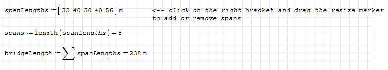

Hey guys.
Maybe someone has a solution for next problem:
I want to allow a user to receive bridge length by entering each span lengths separately.
For example first of all I have variable N (span numbers) that tells me how many times I need to enter span length.
I that possible?
#2 Posted: 2/1/2019 6:28:41 AM
1,443 likes in 2,935 posts.
Simplest way:
With a more graphical approach, you can try with the modeller region.

Wow, thats works just well. Thanks

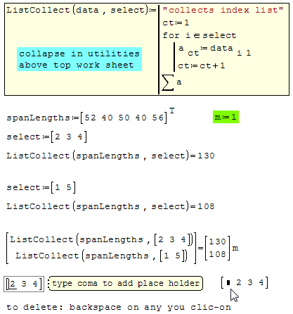

#4 Posted: 2/1/2019 8:33:02 AM
click in front to add upstream
click in back to add downstream
click in front demonstrated only.
So, you don't add separately, you select in group
or individually at will
