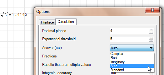

I am having a lot of trouble simply getting a square root to display as a single, positive scalar. There seems to be no option to change from the vector result, which displays the positive and negative results.
My best attempt is to put a modulus around it and turn on "show repeated values only once". However, this gives me the positive value in a 1 row vector, which is not ideal.
What have I missed?
Mark
#2 Posted: 10/20/2013 4:36:47 PM
Go to
Tools -> Options... -> Calculation
and choose "auto" for the "answer (set)" option

I can't believe it was that simple. I think I tried it earlier, but forgot to press "recalculate".
Thanks so much.
