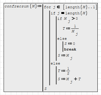

Below is a function to sum matrix of confrac().
