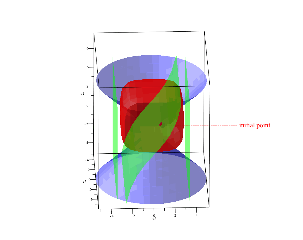

x1^2+x2^2-x3^2=0;
(x1-1)^4+x2^4+(x3-2)^4-81=0;
x3 - 3*tan(0.4*x2)=0;
mod edit: please do not use non-descriptive links, use the proper attachment tools
#142 Posted: 4/3/2024 12:35:52 PM
grelkin2
grelkin2
14 likes in 66 posts.

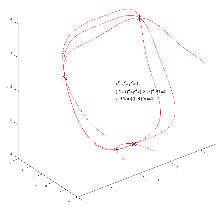

x1^2+x2^2-x3^2=0;
Solutions to check out:
0.591395 -0.801312 -0.995916
-0.555082 -0.759905 -0.941049
-1.898741 1.789592 2.609187
3.362054 2.347994 4.100791
Some initial points:
2.598017 -0.736709 -0.953833
-1.826666 2.073210 4.007231
1.106031 -2.246909 -0.936232
In the figure, the solutions are shown with an asterisk, the red curves are obtained when different initial conditions are given.

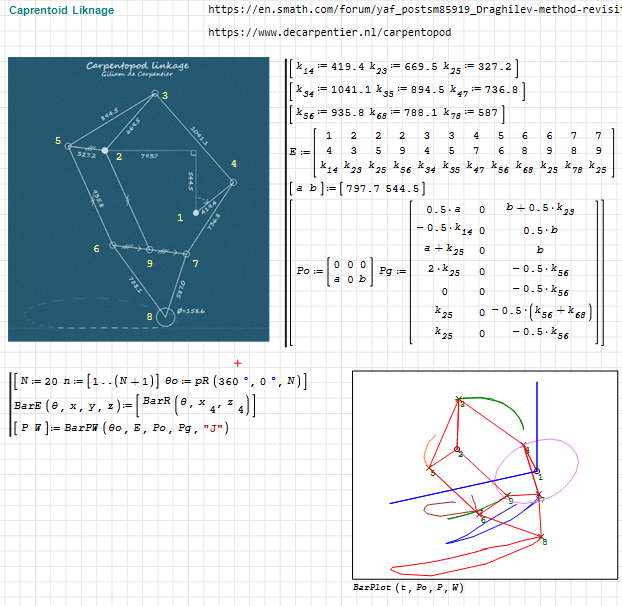

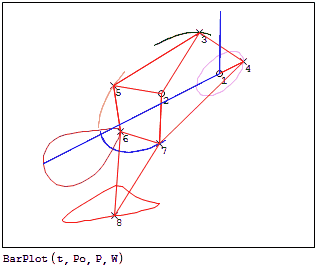

Интересная задача. Как спроектировать стол на шагающих ножках, чтобы поверхность стола оставалась горизонтальной.
Click to enlarge Click to enlarge
Links:
1.Carpentopod: A walking table project
#153 Posted: 10/12/2024 10:57:33 PM

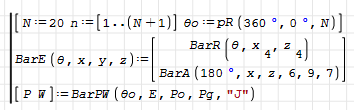

Hi Viacheslav. You can try here the linkage bars system in general, and the Jansen's linkage in particular:
This is an approach to the carpentopod linkage, taking two fixed points. I guess that maybe it must have only one fixed point, BTW, it seems to move the table, although things on the table will probably fall off if the coefficient of friction is not high enough. So, take this just as a case study.
LinkageBars-carpentopod.pdf (601.18 KiB) downloaded 973 time(s).
LinkageBars-carpentopod.sm (704.52 KiB) downloaded 1597 time(s).
Вячеслав Мезенцев 10/13/2024 2:01:00 AM

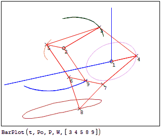

#154 Posted: 10/13/2024 5:13:52 AM
Adding the condition that points 6,9,7 are collinear, we have a stable solution.

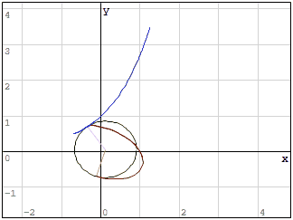

#155 Posted: 10/13/2024 1:19:17 PM

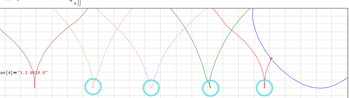

On how to obtain equations of circles inscribed between smooth curves. The Draghilev method is used.
Topic on the MaplePrimes forum.
In SMath:
Inscribed Circles - Dragilev Method.sm (22.91 KiB) downloaded 1538 time(s).
Inscribed Circles - Dragilev Method.pdf (89.12 KiB) downloaded 874 time(s).
Вячеслав Мезенцев 10/13/2024 2:27:00 PM

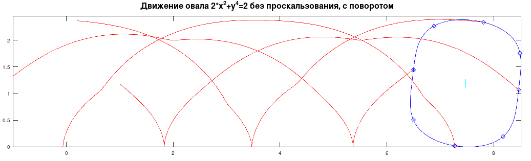

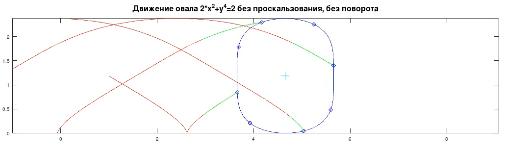

[RUS]Движение овала без поворота и без проскальзывания[/RUS]
[ENG]Movement of the oval without turning and without slipping[/ENG]
olv.mov (419.61 KiB) downloaded 370 time(s).
[RUS]Движение овала с поворотом и без проскальзывания[/RUS]
[ENG]Movement of the oval with turning and without slipping[/ENG]
olv1.mov (519.66 KiB) downloaded 378 time(s).
[RUS]Точки фигуры получаем хотя бы методом Драгилева. Меняем правую часть, чтобы складывалось движение по кривой и движение центра в случае, когда поворота нет. Когда поворот двигаем центра и вращаем точки по окружностям. Незабываем в этом случае вычесть минимальное значение, чтобы овал "катился".[/RUS]
[ENG]The points of the figure are obtained at least by Draghilev's method. We change the right part to add up the movement along the curve and the movement of the center when there is no rotation. When there is a rotation, we move the center and rotate the points on the circles. Remember to subtract the minimum value in this case, so that the oval “rolls”.[/ENG]
Alvaro 10/30/2024 12:11:00 AM

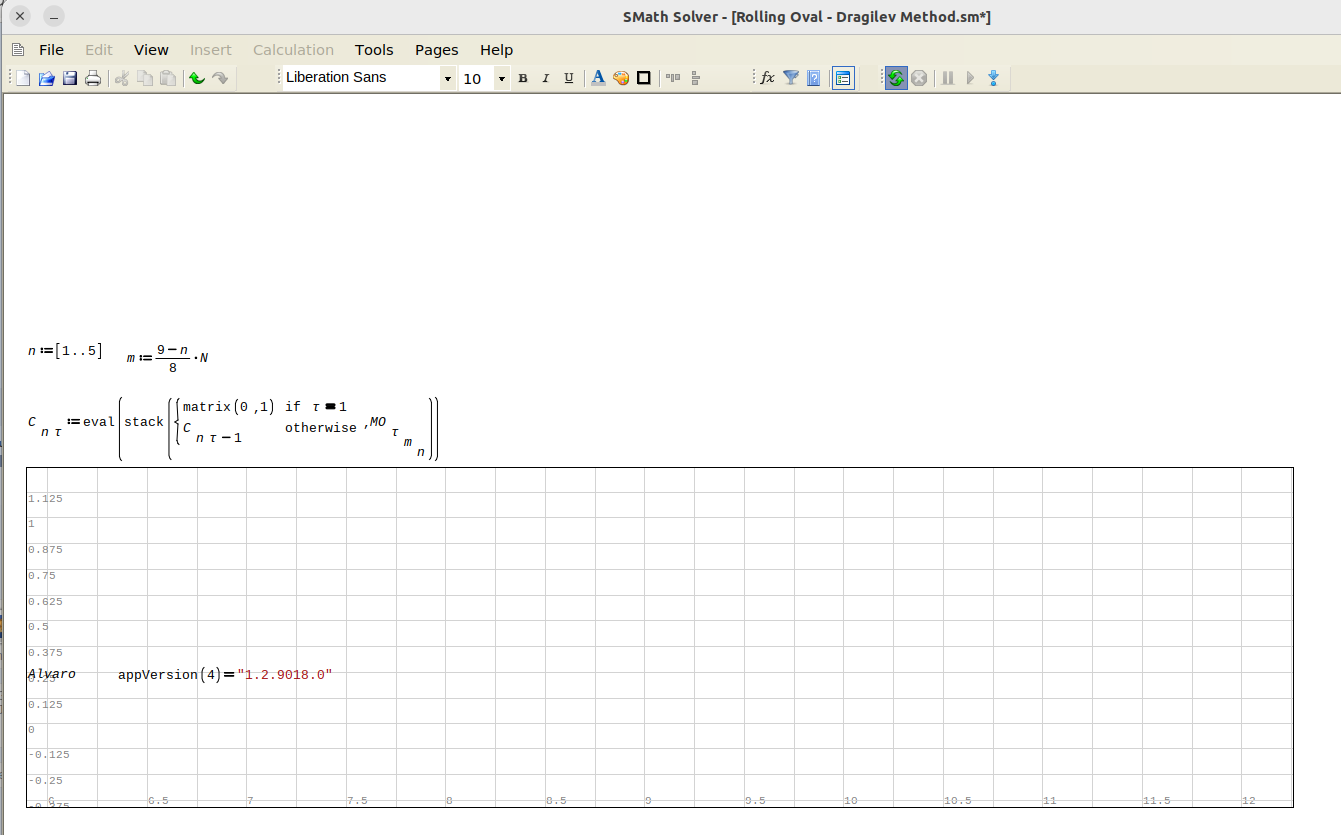

This case, in SMath.
Rolling Oval - Dragilev Method.sm (14.59 KiB) downloaded 1637 time(s).
Very good, but there are some minor drawbacks. In linux smath does not work very well. I have all calculations going on the right side of de system. I calculate the coordinates of the tangent point and respectively the rotation speed of the oval. At the tangent point the velocity is zero and a tick icon is observed.
