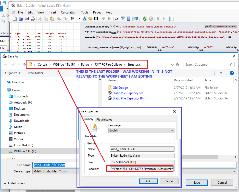

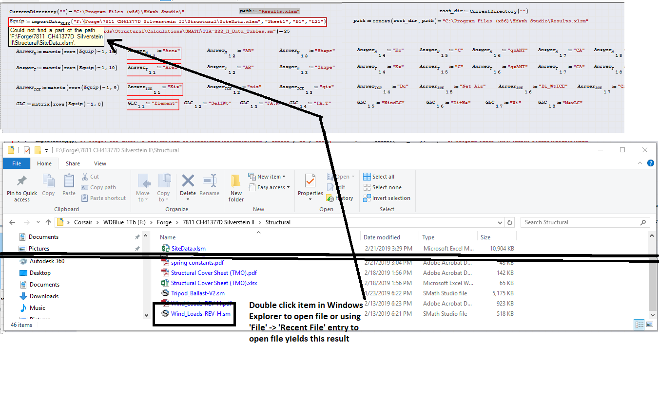

I get this odd behavior opening files from either the recent file menu or by double clicking the SMath file in Explorer.
SMATH thinks the current directory is C:\Windows\.... and therefore it can not find the files I am trying to read in.
Its not consistent, but when it starts happening, I 'fix' it by either: deleting the CurrenDirectory("") and re-writing it, saving the file as the same name or slightly modified file name in the SAME directory, or by signing off or rebooting.
Show Spoiler
I can not figure out if this is a Windows issue or an SMath issue. And now that I think about it, its almost always a referenced spreadsheet, but that is usually what I am bringing in.
I can not figure out what else to attach or debug info might be helpful. I tried searching but couldn't find anything.

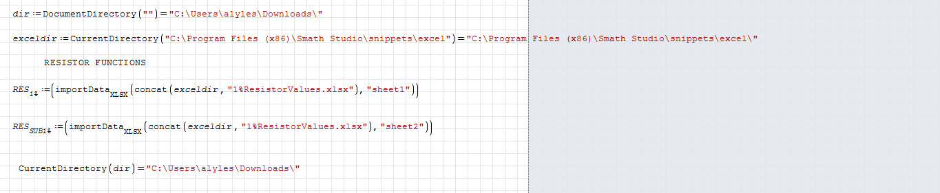

I can't speak to why import isn't working... but you can set the root directory of the smath file better with
DocumentDirectory().
#3 Posted: 2/21/2019 7:09:24 PM
Arie
Arie
93 likes in 285 posts.
I found in a snippet of mine where I import an excel file, I did something like below.
1. Save document directory location.
2. Change directory location to file I want to import.
3. Import sheets
4. return current directory to document directory.
I don't know why I did it like this as I made it years ago, but maybe I ran into a similar issue.

I don't think this is an excel plugin issuse, this is a file handling issue with SMATH.
The reason I am trying to be explicit in the directory and filename is I have the necessary job/project specific reference files in one 'local' directory and the global reference files in another 'network drive' directory location. I am trying to force SMATH to only read and write out to the local directory.
I copy and paste the template files from the network folder to the local job/project folder.
Then when I open the local files, it would read and write back to the network one.
When I try to use the File menu ->Properties it shows the right location.
If there is a better way to enforce file locations, I am all ears.
Dennis

Yes, I probably have that spreadsheet open as I am working. I did not think it was an issue. I will try it with it closed.

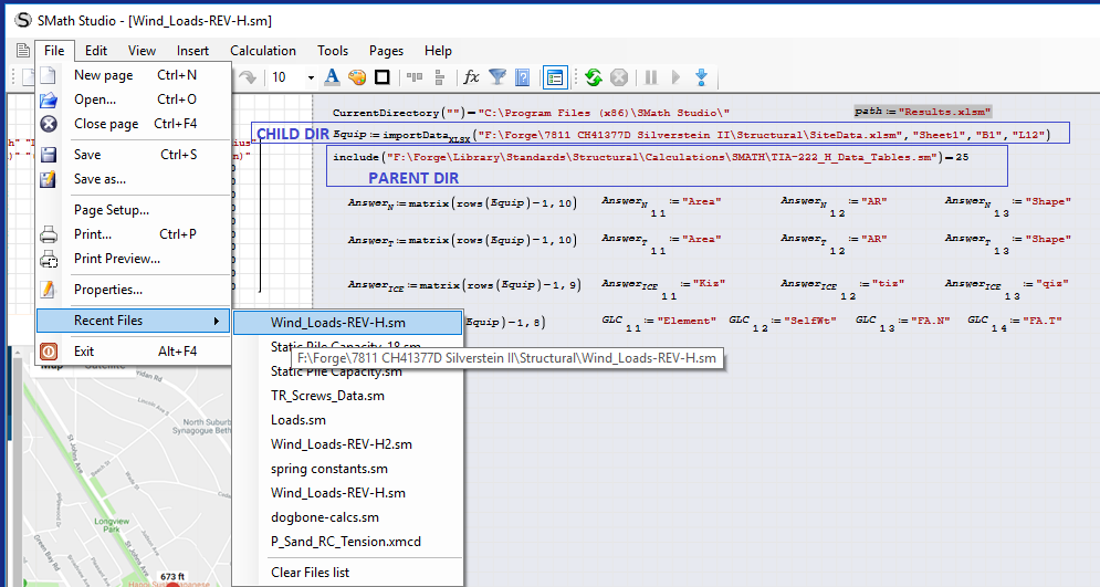

If I do not explicitly define the filenames, then when I copy the files as templates, SMATH seems to remember the origins and relative paths from the origin. So the 'child' SMath sheet finds the 'parent' SiteData spreadsheet.
The referenced include statement, which is obscured in my original post, is pointing back to the 'parent' location of the templates too. Perhaps that is part of the issue?
Even if I open it from the File Menu -> Recent Files -> entry, it opens with the wrong CurrentDirectory().
Then when I go to save it, SMath seems to remember the last directory that I was working in.
Are these both symptoms of the issues you referenced? Is it the same error reported in the newer thread?
See screens below.
The problem with built-in importData and maybe some plugins is that if you are using relative paths and they rely directly on the framework functions, these are using the "Current Directory" to resolve relative paths. XLSX import/export, DataExchange, WriterRegion, are "aware" of this potential issue and for relative paths they rebuild a rooted path internally.
The parent location was pointed because you started your smath session there, then you opened the child in the same session (it is a bug, not your fault).
In short actually you might experience issues:
  • if in the same SMath Studio instance you open different sm worksheets in different locations;
  • if under the first circumstance you are using relative paths on built-in importData() or some other function that rely directly on framework filesystem functions;
  • if under the first circumstance you are using absolute paths created on the fly in the worksheet with CurrentDirectory()
These are all unrelated with the original issue in this thread "Could not find a part of the path ..." that should be solved and was related to XLSX import/export and Data Exchange plugins only. I'll mark this as solved, for the discussion about the wrong "Current Directory" we can use this other thread.
