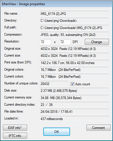

Rather questions:
1. 2.5 MB for 4 simple arithmetic ?
2. What generates the gray background ?
3. Is that what it prints ? Visibility is around 7 % zoom down

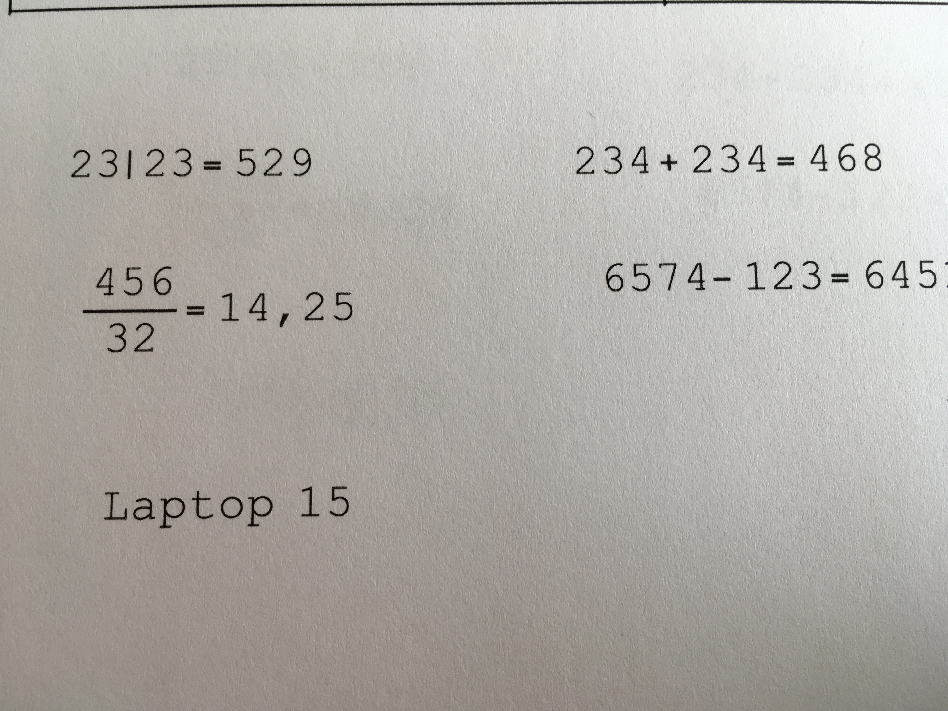

Any suggestions
Rather questions:
4. Check the keyboard style as well.
Sry for the unconvenience, i took a picture!
