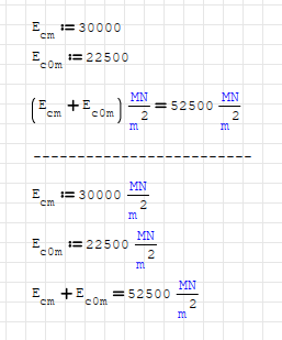

Hello
I’m a beginner with Smath.
Very powerful tool – thanks to the inventor.
I have problem with the units.
Very simple example
What to do that the result is 52500 MN/m2
Any help is appreciated.
Bernd

You are adding two unitless variable and expect result with unit, which makes no sense.
Either multiply addition with unit; or assign units to variables in first place.

@overlord
thanks a lot
Adding the units
(E.cm+E.c0m)*'MN/{'m^2}
was the thing I missed.

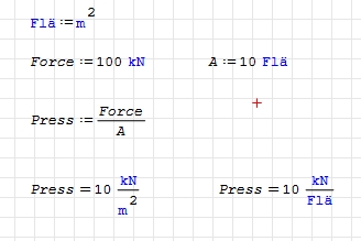

#5 Posted: 3/12/2021 6:02:34 AM
ibruethsch
ibruethsch
0 likes in 3 posts.
@Wb.c Thanks a lot
I Tried the following:
KiN:'KN
Flä:'m^2
Force:100*KiN
A:10*Flä
Press:Force/A=10*'KN/{'m^2}
That looks the way I want.
>>If the units are wrong, then something is wrong in the formula logic.<<
I double that. I appreciate the unit-feature in SMATH.
Bernd
#6 Posted: 3/12/2021 12:55:31 PM
@Wb.c Thanks a lot
KiN:'KN
Flä:'m^2
Force:100*KiN
A:10*Flä
Bernd
Hi. I'm not sure if this comment helps or not, but it's confusing to me the way that you introduce KiN. Notice that 10^3 newtons are 'kN in SMath and 'KN it's "undefined", even it can be used as unit.
Also you introduce another unit, or something like that, as Flä.
If you want to show your result as kN/m^2 or kN/Flä the usual way in SMath is using the "unit placeholder" at the right end after the evaluation with equal:
