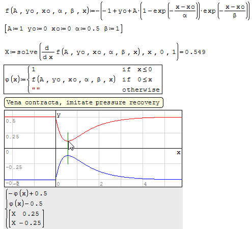

WroteI'm doing internships with students where they measuring for example for different flow the losses in a system.
... few more stuff for your Classroom Internships.
The orifice Plate [ISO-5167] is the standard I have use since Windows.
Previous to Windows, used Sharp pocket calculator iterative method.
Previous to calculating machinery: used the Foxboro booklet and log tables.
One way or another, Iso-5167 implements the 1970 Foxboro.
Orifice plate is an Engineering document.
Inst_Colebrook MOODY.sm (19.13 KiB) downloaded 1128 time(s).
Inst_Orifice Plate.sm (387.98 KiB) downloaded 1195 time(s).
Inst_Flow Profile.sm (673.87 KiB) downloaded 1235 time(s).

#6 Posted: 11/13/2018 10:53:09 AM
WroteThanks also for all the feature documents relating to the orifice/venturi calculation.
1. [1975..77] I was involved with the Montreal sewage pumping station, at the time the world
biggest project of the kind, presented to an International Symposium [Yougoslavia].
17 pumps 100000 UGM each, of which two variable speed, 139 ft deep. At the top discharge, 17 Venturi
flow measuring devices, each 8 ft diameter [Brooks ~ 1000000 $ each] Pump engine 4500 HP each.
2. The best beta ratio [Orifice Plate] is around 0.62. Installed in machined meter run and lab tested
give the best accurate mass-flow rate. An industrial plant may have 100's measuring points. It won't
be be practical to have each flow meter associated with its own calibration. Instead we calculate/bore
each orifice plate with its own beta ratio, thus minimizing the burden of the Instrument Men !
No point to purchase expensive Orifice Plate software, Smath does it just perfect.
