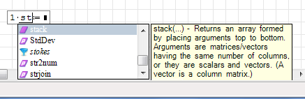

Yes it is by design; a variable name cannot start with a number.
This is a standard almost everywhere (there are few exceptions); it keeps consistent and fast how to identify a variable both for humans and for the core (because you have to check only the first character).
You can use p1, pos1, Position1st, ...
If you define a variable with the same name of a unit, the variable s shown as first in the dynamic assistance, otherwise you have to type at least another character (if there is a 1-character unit or function already defined)

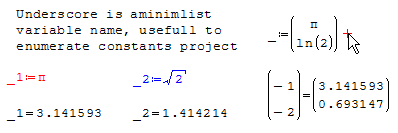

#6 Posted: 3/16/2016 3:16:32 PM
frapuano 3/16/2016 5:13:00 PM
