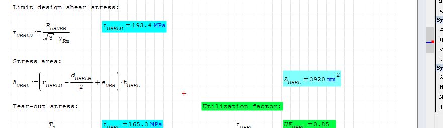

SMath Forum SMath Studio Bugs & Problems Red Dot Error Mark 1 Pages (4 items) Red Dot Error Mark - Why there is red dot error mark - Messages Go to last post #1 Posted: 2/21/2019 4:38:03 AM David Wildner 0 likes in 3 posts. Group: User Hello, still quite new to SMath...been wondering why there is red dot error mark on side when all regions seems to be computed correctly? #2 Posted: 2/21/2019 5:04:13 AM overlord 598 likes in 1,380 posts. Group: Moderator Switch from "Pages View" to "Printing Bounds" (next to zoom slider, bottom right corner)And see if there are some calculations which not included to gridded print area. #3 Posted: 2/21/2019 5:08:47 AM David Wildner 0 likes in 3 posts. Group: User Thx a lot overlord!!!! Solved. #4 Posted: 2/21/2019 8:04:39 AM Andrey Ivashov 2,343 likes in 4,043 posts. Group: Super Administrator Hmm. This is an error. Please could you provide a file to me? 1 Pages (4 items) New Posts No New Posts
