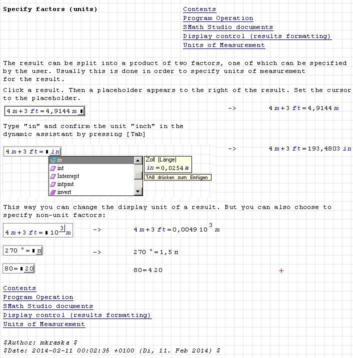

#3 Posted: 3/3/2014 9:15:15 AM
1,355 likes in 2,270 posts.
You can do that right now.
The attached help page is found in the interactive handbook under
Toolbar [?]> Units of Measurement> Units in Results Display
Radovan Omorjan 3/3/2014 10:13:00 AM
#4 Posted: 11/13/2014 1:23:54 PM
zapzapouch
zapzapouch
0 likes in 27 posts.
That's just setting the units manually, though. It should be possible to specify the unit as "m", and it automatically displays "10 nm" or "10 km" when the number changes, without manually typing in "km".
