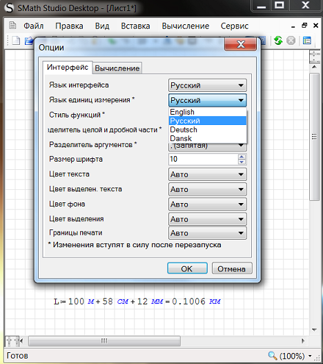

Why this not working?

I use russian units. They do not work. I don't know is this a bug or not. English units are working fine.

Thank you Radovan, now it works fine (default was English.).
