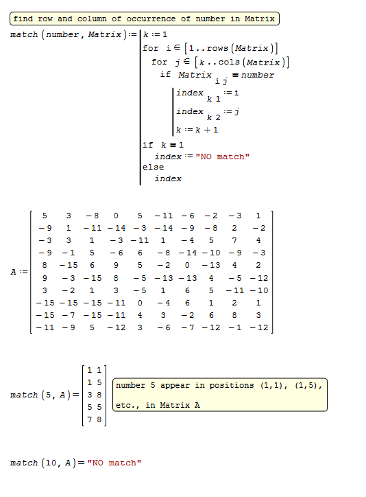

Hello, I'm searching for some function like match(z, A)(Looks in a vector or matrix, A, for a given value, z, and returns the index (indices) of its positions in A) in Mathcad.
I will appreciate any kind of help.
#2 Posted: 11/22/2011 5:34:55 PM
Hello and welcome ,
There is no such function in the function list. Therefore, we could make a user defined one. I hope this will get the job done.
[LIVE width=443 height=419]http://smath.info/live/?file=3273[/LIVE]

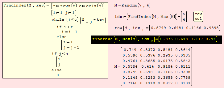

Can I acess this function?
#5 Posted: 10/13/2022 10:04:54 PM
Can I access this function ?
findrows from Smath menu f(x) may just be what you need.
Truncate the matrix/vector to avoid residuals smaller than 10^-15
For more complicated investigation, visit Samples Find Index
posted few days ago ... lot more involved.
Cheers ... Jean.
#6 Posted: 10/14/2022 9:12:57 AM
findrows has limited use unless for specific end use wrt Bolean '0'
For long square/rectangular matrix, better use the assisted code.
match.sm (11.95 KiB) downloaded 1691 time(s).
Some good improvements suggested by Razonar: versions of match() function
Alvaro 10/26/2022 6:07:00 PM
