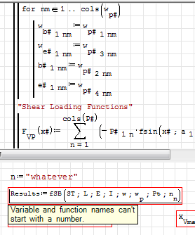

Attached is an older worksheet for simple span beams. It used to "work". However, now I receive an error "Variable and Function Names Can't Start With Number". I can't seem to find this error.
Any help would be greatly appreciated.
Thanks!

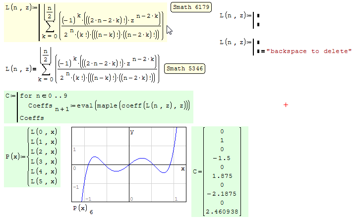

That what it means. Since 6179, Sum needs be locally defined.

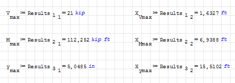

1. I seem to get a bad result (it is incorrect) as noticed by the units. I'm not sure what's going on there.
2. Where is 'n' being defined in the original function? Or do I need to clear(n) before every sum?

That's what you have to isolate first, it was created 5346 or earlier version.
If so => the suspect is the Sum(s). Personally, I have dozens of those.
Good thing we know how to doctor.

Thanks for you help. A couple questions:
Not really sure what's going on there while the units are correct, but they shows that something is messed up. What is going different is that nested systems are no more joined (at least for the el() function).
You can use a couple of nested el(), that however are correct for how the result is built (a system of systems)

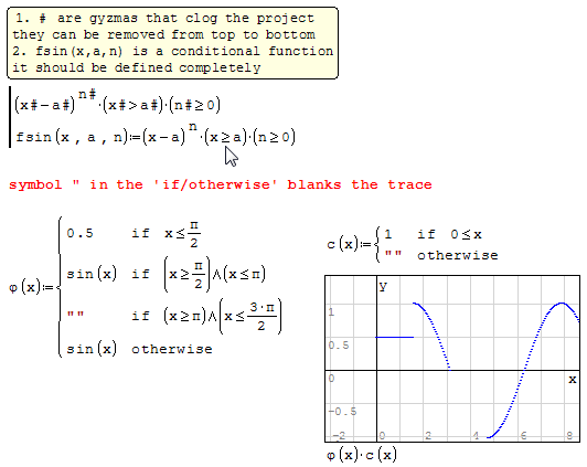

Please, check the attached:
1. Not a case of clearing anything
2. Changed the nSum for mSum
3. Removed all gyzmas #
4. NO error message
I understand nothing in that kind of work,
but results make sense even with units.
Simple Beam - Copy.sm (63.58 KiB) downloaded 758 time(s).
