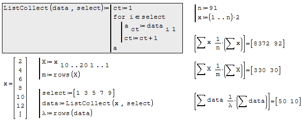

Summation EX.sm (214.79 KiB) downloaded 1222 time(s).
#3 Posted: 2/19/2020 9:57:35 AM
Could you please tell me how can I accomplish this?
There are many to skin a cat.
