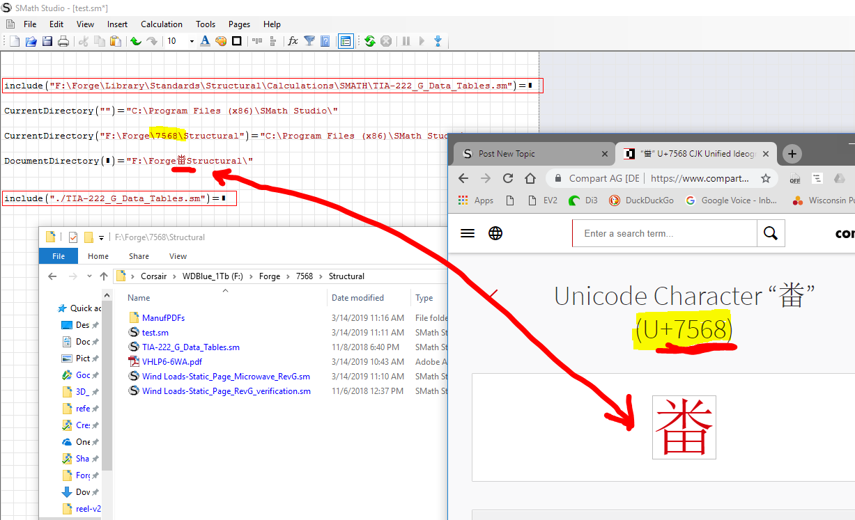

I am encountering an odd error with the newest version- it seems that SMATH is taking part of the path as a unicode formatting for a character.
In my case, 7568 is being read in as a Chinese character. It did not do this before.
I am not sure if this is also throwing of my include statements. I can not read in files I used to be able to.

I am aware about this issue. Will require change of unicode symbols pattern in SS and automatic worksheet correction on opening.
Will be fixed in future SMath Studio versions.

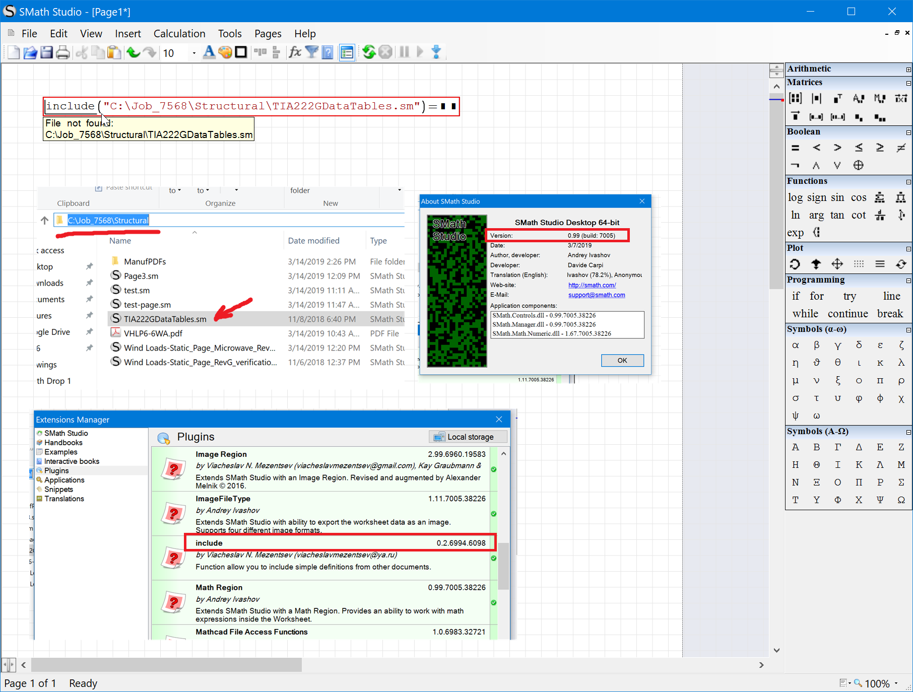

Include_7005-2.pngSo is the include error related or a whole other issue? I tried to simplify the file and file location, see the results below.
I rolled back to build 6894. The include statements work fine in that version.
In 7005, it just can not find the files.
I tried to include the version numbers for program and plugin in the screens.
EDIT: The images were not showing up right. I put them and the attachements inline.

Not to sound ungrateful, but many of my worksheets are broken. I will admit to becoming complacent and comfortable in SMath's stability and accuracy. I am in the middle of this perfect storm since i organize things by number and tried to organize my work to point to central library's of files.
I am finding it hard to believe that after a week and ~38k downloads, I am the one who is discovering it. Again, not complaining, but I know that there are many other more capable programmers and users out there.

Reproduced. Looks like something broken in Include plug-in. Checking...

Fixed. Please update Include plug-in using Extensions Manager.

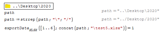

Hi there,
I am encountering the same problem in Smath build 7030, include version 0.2.7013.1762: File not found.File not found..
I have a path that has "\2020\" in it, which turns into the unicode character U+2020 => dagger. Also when I simply type path := "\2020\", the character pops up, so without using the include function. I need the path for exportXLSX.
I was wondering if there are any new updates on how to solve this problem.
Thankyou!

as workaround you might input the path using forward slashes (/) instead of backslashes (\). This should mitigate the issue at least (the framework accept both formats as valid OS path).
Thankyou for your response Davide! I am currently using this workaround, which is fine for my own use of the program. However, for sharing the calculations it would be much easier to use DocumentDirectory() or even allowing others to copy their paths from windows file explorer. This saves having to explain it to them, as in both cases, a string with backslashes results and the unicode characters appear.

I know... the special characters feature has several implications, that's why there isn't an easy fix.
Following the forward slash path workaround, you can use path picker region to import easily the path and then apply a filter to automate the change.
Show Spoiler
(the backslash before the filename is intended, you can mix the slashes and it still works... not nice to see but it works)
