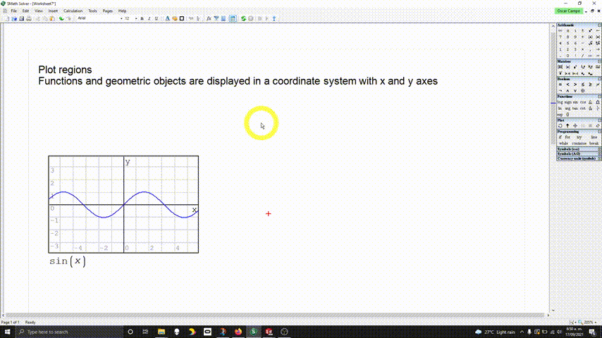

#6 Posted: 9/17/2021 10:10:10 AM
Oscar Campo
Oscar Campo
124 likes in 298 posts.
Dear SMath-user and developers,
I have a question regarding a commenst in pop-up, if one with mouse selects a text-region.
Please see you a screenshot hier below.
Best regards,
Andrey
Maybe this can help you:

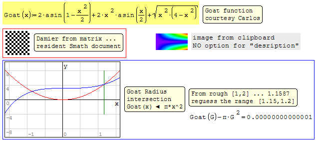

#7 Posted: 9/17/2021 10:13:03 AM
983 likes in 6866 posts.
That's my understanding.
