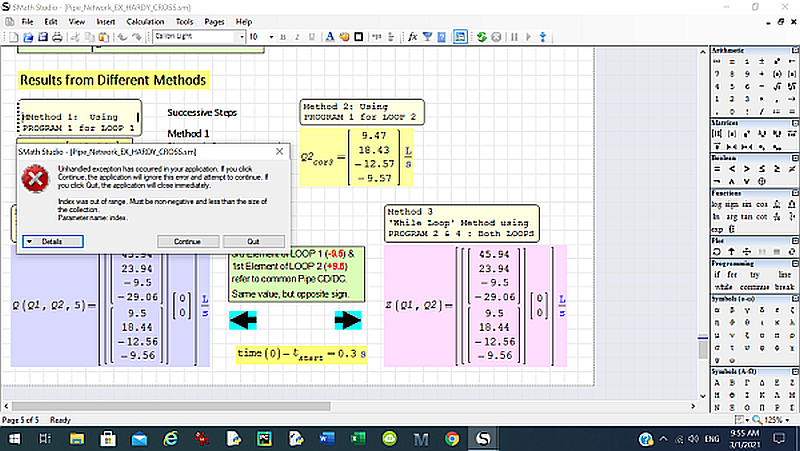

Whenever I try to edit contents of some description boxes the unhandled exception error message props up. For information of Developers please.
Please attache the content of the "Details" window.
Details Window.txt (30 KiB) downloaded 40 time(s).
Pipe_Network_EX_HARDY_CROSS.sm (299 KiB) downloaded 46 time(s).

Both issues fixed. Thank you!
