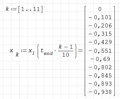

This is because the solution functions are defined using interpolation. The interpolation functions have the X and Y vectors and the value of x as arguments. You try to provide a vector for x. Vectorize can handle only matrix arguments of the same size and successively calls the function with the j-th element of each vector.
So vectorize would require your x vector to be of the same size as the data vectors. Even in this case this probably will fail because the data would be reduced to a single X_i and Y_i.
Therefore, you have to use a loop.
![2024-01-29 10_30_32-SMath Solver - [Three-Planets (Mathcad Block).sm_].png](/en-US/files/Download/xaHeCk/2024-01-29-10_30_32-SMath-Solver---[Three-Planets-(Mathcad-Block).sm_].png)
