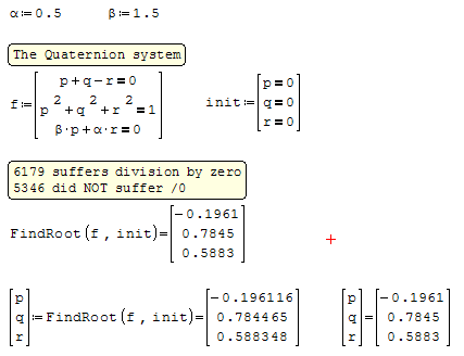

#1 Posted: 12/29/2016 7:36:29 PM
This bug is strictly Smath 6179.
5346 didn't suffer the undefined binary '0'.
Bug 6179 Zero.sm (9.96 KiB) downloaded 1061 time(s).
#2 Posted: 12/29/2016 9:20:48 PM
1,443 likes in 2,935 posts.
This is a known problem of Nonlinear Solvers plugin wrt SS 0.98; in this case the next version seems working fine:
