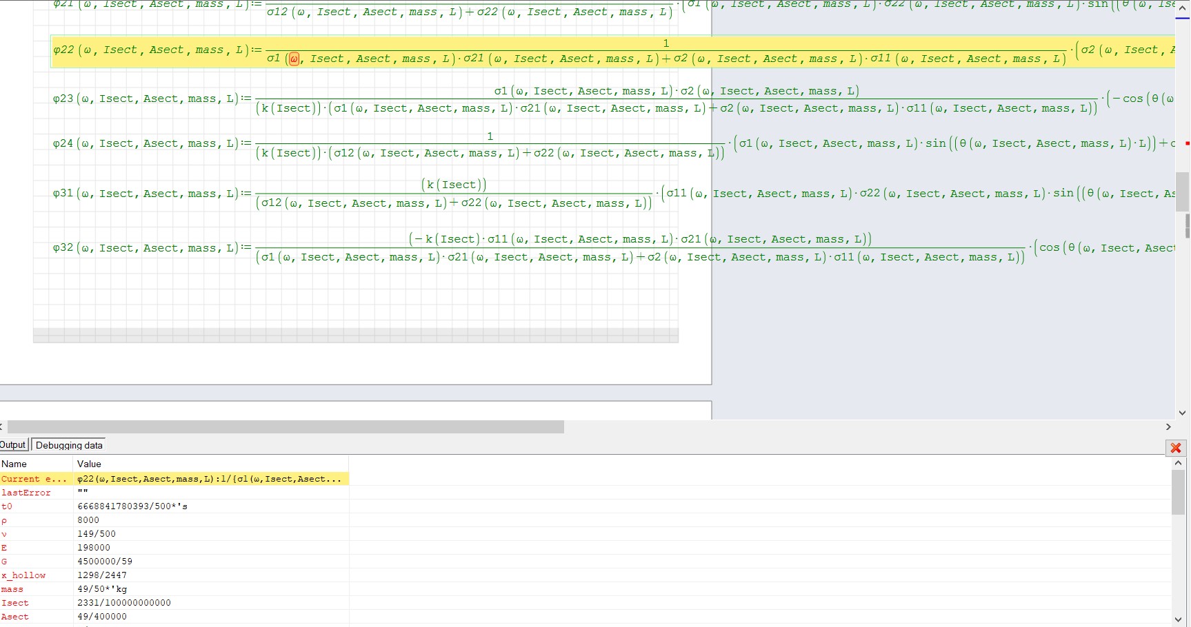

Hi JEAN,
I tried to run your last sheet (TMMT plot roots.sm) BUT a new bug (unknown until now) jumps out
for ALL my sheets involving TMMT algorithm (so, your sheet included....) : could you give me a hint
to solve it?
I'm very surprised and a bit upset: it's not matter of scientific calculation but debugging....
To be noticed that the bug involves SMath sheets previously working correctly (even if something was
signaled, randomly, in the past, for the same function BUT without any effect on calculations)
Many Thanks
Fabio

.....sorry JEAN to bother you...but I've solved the issue I hinted before...apparently I have ticked (and forgot) the option "Pause" in "Calculation/On Error"...
sorry..I'll check TMMT plot roots.sm asap and let you know
