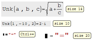

#3 Posted: 11/8/2021 3:00:08 PM
Hello Jean and Thanks for answering my post... However I can't figure out what you are showing me. I guess I'm thick today.
After trying to play with Ctrl+= I looked it up and found...
Ctrl+= - Insert Boolean "Equal to"
I tried starting the text entry with a " and that kinda works if I put space after numbers...
For example:
It seems like sMath knew this was all text...
"is 2 + 2 = 4 or is it = 5
but with no space after numbers it thinks its a mathematical function like entering...
"is 2+2=
won't let me type text after it and yields the answer "4"
For reference: The original questions were...
1 - How to enter the equal sign in as text?
For instance entering an all text comment like this:
"The formula is = to the square root of a+b/c"
2 - Anyway to make the ICONS larger on the Toolbar?
So I'm still unsure of the answers for either of the two.
Thanks again for responding to my post.

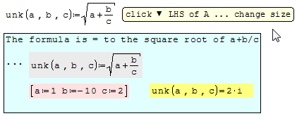

On the question there was a minimum of debate (here on the forum). The author has introduced this automation to recognize mathematics within a text to give the possibility to define mathematics in the text. For some it was too invasive and some correction was made by the author. We need to become familiar with the instrument and is acceptable but it is not a dogma.

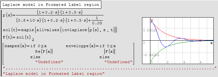

... Formatted Label is lot more advanced/presentable.
Image Formated LABEL [Oxyhemoglobin].sm (17.32 KiB) downloaded 1307 time(s).

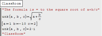

Jean,
I downloaded and installed the "Conditionally Formatted Labels" Plug In you linked to.
To get it started I took the cue from your reply and found...
Insert > Writer Region
I entered a few lines having to...
Shift Click at the end of each line
I discovered if I Right Click in the region and click "Settings"
I get the Text modification Dialog
Where I can color lines, bold text, find special symbols, etc.
Cool! Hope I did it right. It seems to work so maybe I'm in the ball park.
Is that the proper procedure for using the Conditionally Formatted Labels Plug-In?
Thanks for your help !

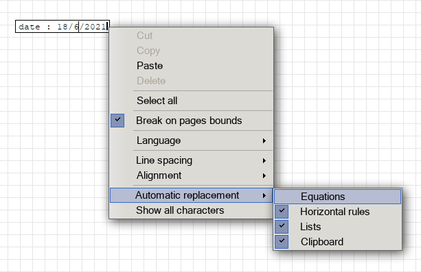

The "Deactivate Text Region" option in the Edit Menu only appears under certain circumstances it seems.
I must start typing the first word and then click Edit and Deactivate Text Region appears and I can turn it off...
but if I type a word and hit space... the option is not there.
Am I missing something on finding the Deactivate Text Region option?
The "Automatic Replacement" choice under the Edit Menu
is also hard to find as it only appears after I type a word followed by a space.
So, same question...
Am I missing something on finding the "Automatic Replacement" option?
BTW, once I found the "Automatic Replacement" option and turned it off for Equations
It seemed I could enter just about anything with out sMath wanting to calculate...

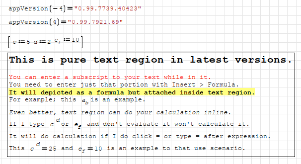

WroteWhere I can color lines, bold text, find special symbols, etc.
You can do most of things you need with only Text Region.
You can change font, size, bold, italic, color, background color, etc.
You mostly won't need writer region plugin.
We couldn't change internal Text Regions fonts, size, etc back then.
Writer Region plugin was an attempt to include that needs.
Now I use it only for very niche editings.
Jean insists to use very old version of Smath (build 6179).
That old version doesn't have a lot of latest release capabilities.
And it has some calculation errors too. (ref: Andrey, author of SMath)
Conditional Format Label plugin has totally different purposes.
Please download the Reference Book from Tools>Plugins>Interactive books.
And read the CFL plugin section.

To the best of my knowledge, there are a two options:
- Turn off Automatic replacement --> Equations:
- This is an option for any given text region (context menu)
- This setting can be turned off and saved as 'default'; the file "...\[USER_NAME]\AppData\Roaming\SMath\settings.inf" supports the setting: 「AutoEquations=false」
- manually type (or copy/paste) the character code: 「\003D\」: this will auto-convert to the 「=」 when typed in a text region
\003D\
