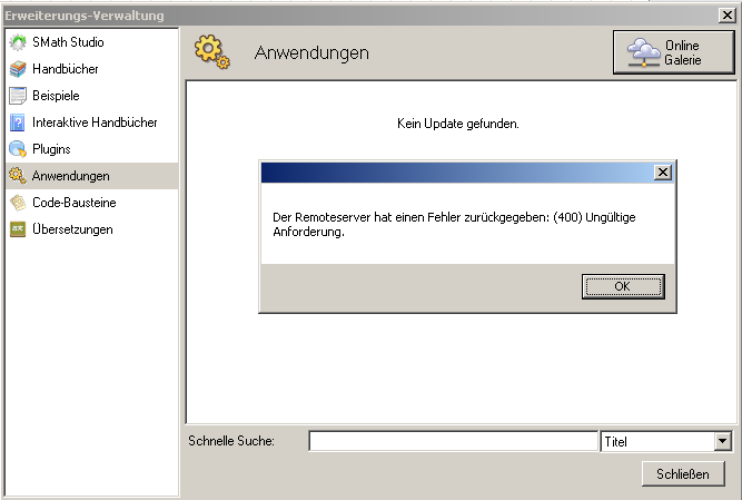

When using the installer version 0.97, I had to remove the complete extension folder of the previous installation in order to get access to the online gallery for updating the plugins.

I cannot access the applications from the online gallery, neither in the installer version nor in the (otherwise reliable) portable one.

After complete removal of all remainders of installed versions and new installation with complete acceptance of all presets (including install path) the access seems to work now.

Fixed. The issue was on server-side (at smath.info). Appeared for those who used many installed plug-ins. No SMath Studio update required.
