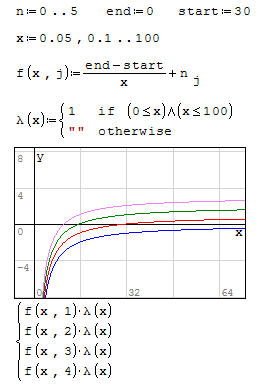

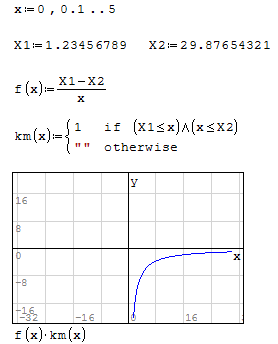

Is there any possibility simply to plot the chart where on Y-axis I simply put the a(t) and on x-axis time??? Because this what you proposed it looks tricky and there is necessity to control units. Therefore it is not intuitive ( at least for me ;P )
Please check the photo below made by ptc mathcad. This what I want to do, is to write the same as the function and plot it using the SMath.

In your conditions, only the speed and deceleration time are set.
Therefore a =const.Perhaps there are additional conditions
which you are not reporting.
If that plot is what you need, here is your answer.
With function, dots for values and new axes grid {0.05, -2}.
plotting_range.sm (10.98 KiB) downloaded 1120 time(s).

Hi Ber7,
This the acceleration during the breaking from 30km/h to zero in linear movement. Therefore in fact there is a(t)= v(t)/t. So: a_i= v_i / t_i and this is function where t is in some range, and i is the iterative change of time ie. the position of specific time. This what you wrote, is not the function of acceleration versus time.

@ Jean Giraud and @overload Thank you !
This is what I wanted to write in SMath!

Hi. I agree with Ber7 that in absence of any other information the deceleration is constant. Physically that's means that the force of the breaks is constant too, which seems to be a good approximation, neglecting friction forces and some torque considerations about the wheels.
Hi Ber7,
Mateusz
Yes it is: a(t) = constant for t in the interval 0 .. 10 s.
