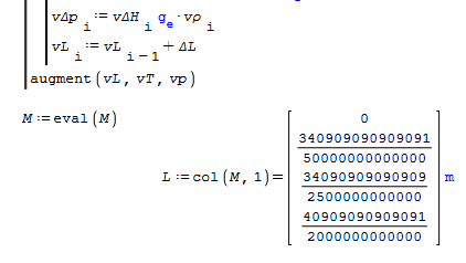

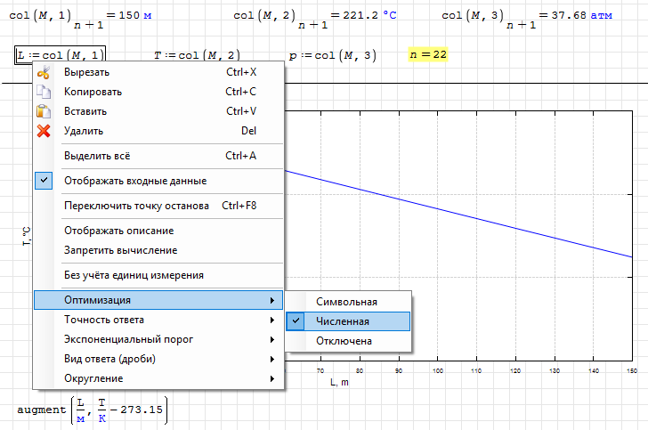

#2 Posted: 7/14/2023 3:58:39 AM
1,555 likes in 1,867 posts.
Указать численную оптимизацию.

#3 Posted: 7/14/2023 4:09:23 AM
Valery Ochkov
Valery Ochkov
66 likes in 697 posts.
Спасибо!

... И много таких подводных камней в SMath?
Hi. That's not SMath pitfalls. It's a feature: SMath remembers the intermediate steps of what it's calculating, unless you tell it to forget them, with eval. This also usually speeds up the following steps.
