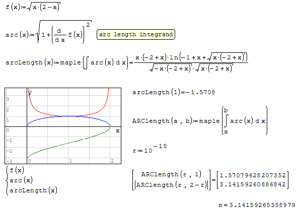

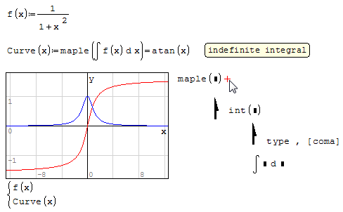

Generally, like this.
Davide Carpi 5/12/2018 3:23:00 AM
#3 Posted: 5/10/2018 10:35:04 PM
... more procedures.
Integrate_000000 [ Source Code Maple].sm (9.66 KiB) downloaded 1279 time(s).

1. click on the image, copy
2. paste in Smath
3. DIY [Do It Yourself]

Welcome to the forums. Jean's first post outlined a how to create the indefinite integral, although it might not have been clear.
For example, to create the integral for x^2, you can type "int(x^2,x)" without quotes.
I do not believe there is a toolbar button for the indefinite integral.

Thankyou. int( x^2,x) was what I was looking for (and I see now what that first picture was suppose to be /headdesk). I tried the example mentioned above with maple installed but I don't see the answer like I saw above. I see this instead.

Try right click and change optimization to symbolic.
Also you can use symbolic evaluation by hitting Ctrl + . (That is Ctrl and period) instead of =

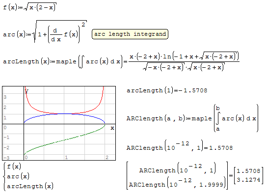

Copy the image, paste in blank work sheet ... try to do it yourself.
Try hard !!! rescue yourself by downloading the work sheet.
It should work in your latest Smath version.
Integrate Wisely [Arc Maple].sm (8.54 KiB) downloaded 1024 time(s).

... this attached example is of prime importance.
It shows by how much the Simpson integrator can be OFF track !
Not even the first decimal is true !
Integrate Wisely [Arc Lagrange].sm (44.76 KiB) downloaded 1013 time(s).
