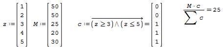

Worksheet7.sm (4.2 KiB) downloaded 1457 time(s).
M*c / c*c would also do.

Aha, that should work.
Thanks!

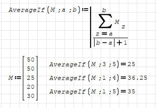

This is another way.
AverageIf.sm (5.16 KiB) downloaded 1492 time(s).
NDTM Amarasekera 12/28/2023 5:38:00 PM

Took me a couple of minutes to wrap my head around this one, but now it makes sense.
Thanks!!

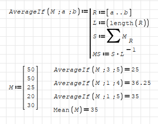

This maybe an easier way.
NDTM Amarasekera 12/29/2023 9:03:00 AM
