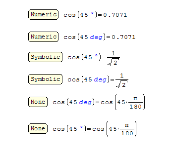

Hi [userlink]Kasperhaack[/userlink]
To show or to customize an output unit you must type the apostrophe on the placeholder in the right side of the equation, and then you can type the unit ° or you can choose one from the list that appear (the dynamic assistance box).
EDIT: see also UNITS ON WIKI
regards,
w3b5urf3r

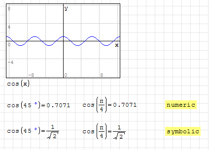

Kasperhaack,
In the same way you can use degrees inside trigonometric functions:
cos(45° )=0.7071
Oscar

#6 Posted: 5/8/2013 6:57:58 AM
looks like they're back problems with degrees in 0.96.4875 version.
such as "cos (45°)" does not work in numeric mode
works for me (win7 x64)
