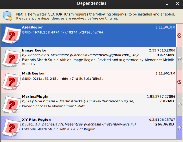

Unfortunately Maxima is not supported under Linux ..I am using MONO version
Also Image Region plugin is bugged under Linux
Extremely thanks for help anyway
