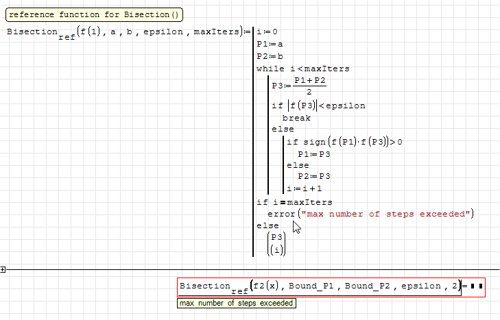

Hi everybody,
Please, are there some examples for the use of error function ?
Ioan
#2 Posted: 9/8/2012 3:55:07 PM
1,443 likes in 2,935 posts.
Hi everybody,
Ioan
See the attachment
regards,
w3b5urf3r
EDIT: new wiki page for error added
