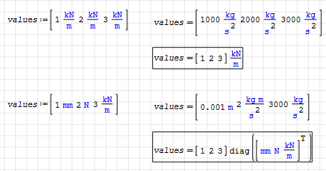

... I was able to convert mm to m (my database has plain values, but they are supposed to be mm). But next step is to display final results in kN/m, but I keep getting kg/s^2. ...
Hi. Something like this?
My guess is his data is something like this.
That's what I deduce from his description at least.
Without him posting datasheet we can't help any further.
