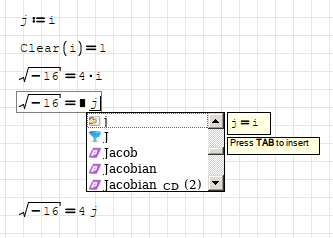

#3 Posted: 3/10/2023 3:33:00 PM
585 likes in 1,355 posts.
You can't totally remove i assign.
Or swap i with j via editing Constants.xml.
It is hard-embedded to smath code.
Clear(i) gives 1, which falsely results as it worked.
But it won't actually be removed by Clear().
However, you can assign sqrt(-1) or i to j.
Results placeholder can be edited with j.
And you can reassign you i result to j.

#5 Posted: 3/10/2023 7:34:36 PM
Am I understanding correctly then that there isn't a real way to assign lower case i as a normal variable and use it for a real number then ?
Here, 'i' is scalar wild real.
#6 Posted: 3/10/2023 7:39:56 PM
Thanks for the assistance! Am I understanding correctly then that there isn't a real way to assign lower case i as a normal variable and use it for a real number then? Just double checking.
Actually you can, but j won't constantly swap with i.
Every worksheet should have j:sqrt(-1) at top.
i will have what you assigned. variable, real, etc.
But when you calculate something which results as sqrt(-1),
it will considered as i again.
While i still has another value,
calculation still gives it as sqrt(-1).
But when you directly call i,
it will have what you assigned.
