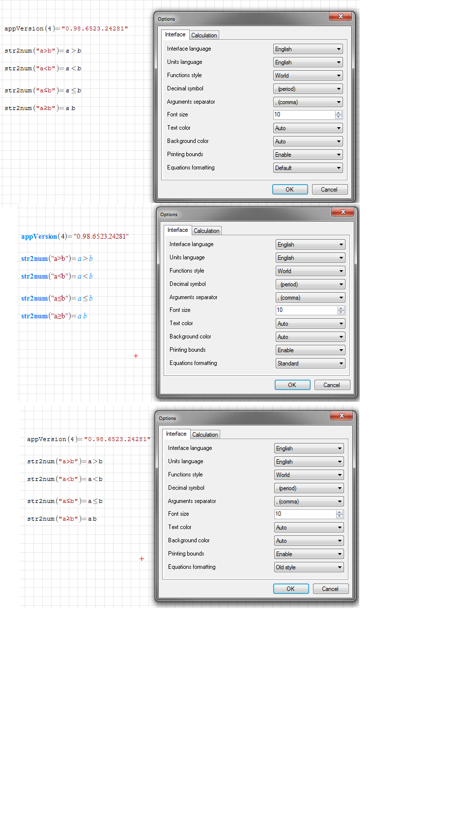

#21 Posted: 11/11/2017 7:44:05 AM

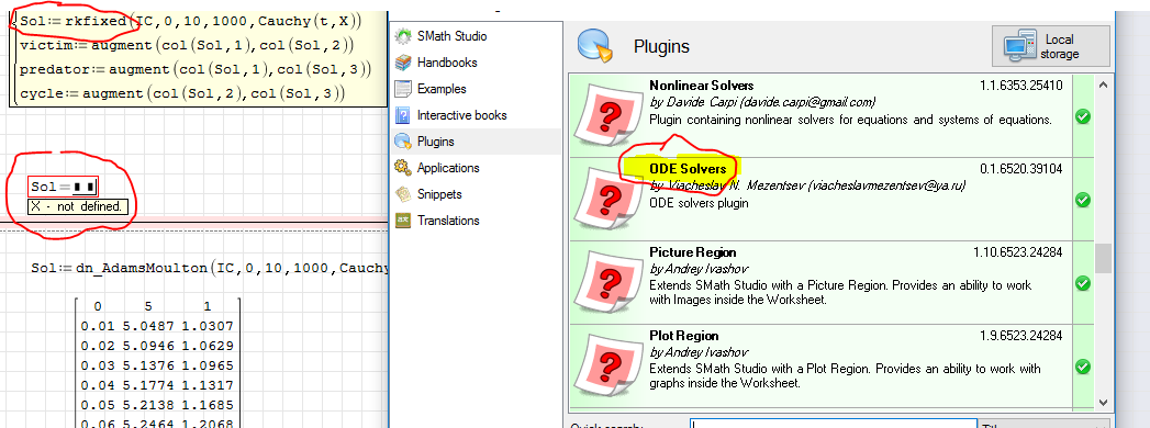

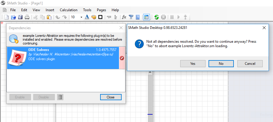

Bumped into the problem of ODE Solvers plugin and the recent build. Started the example for ODE solving from the Martins's Reference book. Tried to delete and reinstall ODE Solvers, example started once and but the problem persisted after the second run.
#22 Posted: 11/11/2017 10:37:38 AM

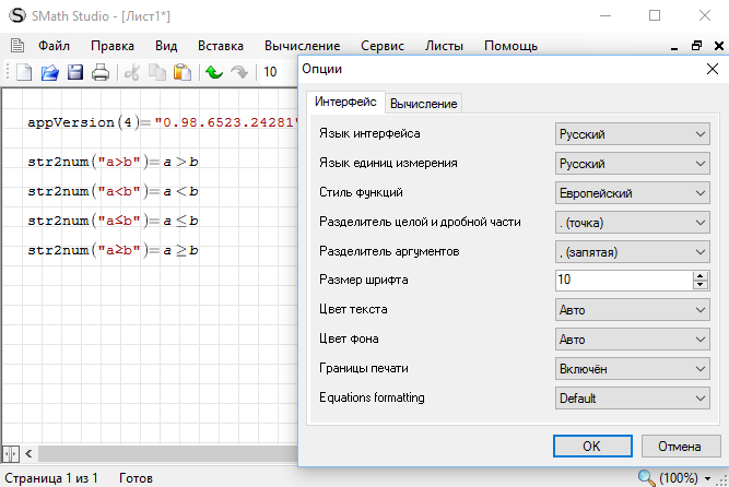

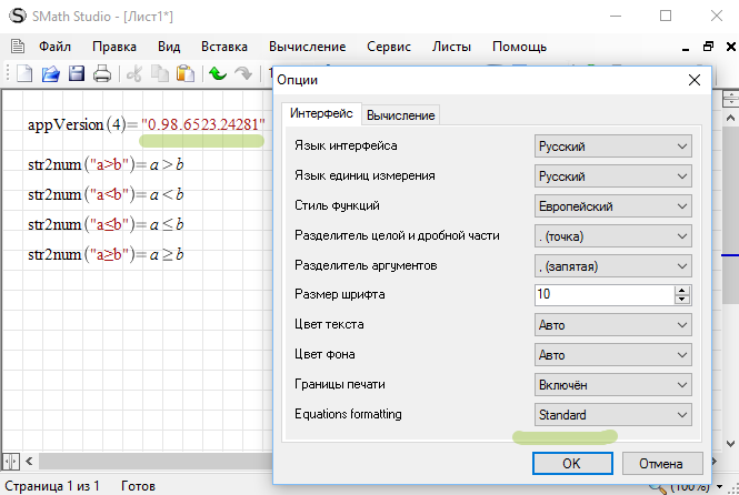

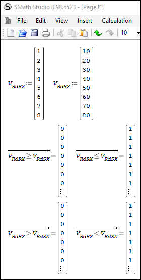

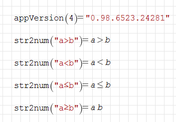

WroteThe reported problem persists (post #11), but it is specified that it is only for the >= and not for <=, > , <.
Hello.
Unfortunately I can't reproduce an issue with >=. Could you please doublecheck? Version is 0.98.6523.
boolean_check_1.sm (5.58 KiB) downloaded 1350 time(s).
#23 Posted: 11/11/2017 11:13:24 AM
#24 Posted: 11/11/2017 12:25:53 PM
Martin has already answered for me.

#25 Posted: 11/11/2017 5:33:55 PM
WroteBumped into the problem of ODE Solvers plugin and the recent build.
Just say "Yes continue" and open the work sheet.
Done otherwise: double click on the file from it's location,
"Yes, continue" it should open the work sheet all functional.
ODE Predator Prey [rkfixed Cauchy].sm (7.52 KiB) downloaded 1278 time(s).

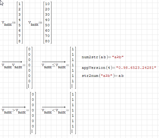

#26 Posted: 11/11/2017 11:11:07 PM
WroteHow about indicating the formatting scheme (e.g. in the status line)?
Bolean should be specified completely. The example > ... < is trivial
If not specified completely, all sorts of error messages will be issued.
Mathcad was more tolerant, thus much less educative than Smath.
DeBoor argument v< ... is however completely specified wrt to its neighbour
if((el(u,μ)≤v)&(v
Vector Maths.sm (1.06 MiB) downloaded 1555 time(s).

#28 Posted: 11/12/2017 11:32:37 AM
#29 Posted: 11/12/2017 4:03:33 PM
WroteWroteBumped into the problem of ODE Solvers plugin and the recent build.
Unfortunately, this will not work for me (Windows 10, 32bit)

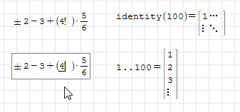

Better
A couple of issues I still found: horizontal alignment of factorial and vertical ellipsis

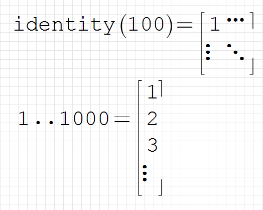

Broken right bracket of matrices changing font sizes (starting from 16pt):
![2017-11-15 00_19_21-SMath Studio - [Page1.sm_].png](/en-US/files/Download/aadUMM/2017-11-15-00_19_21-SMath-Studio---[Page1.sm_].png)
