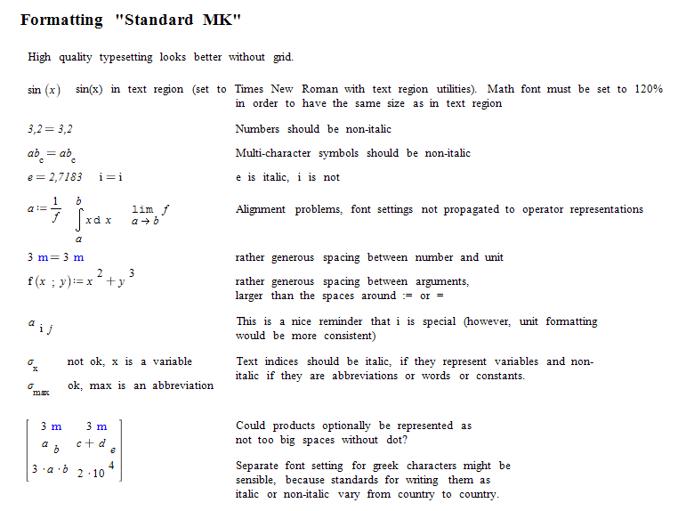

#2 Posted: 11/7/2017 6:23:03 PM
The new formatting options look promising.
Is there a reason for having all fonts downscaled to 80% in the pre-set configurations? I feel like compensating this by changing the font size to 12.

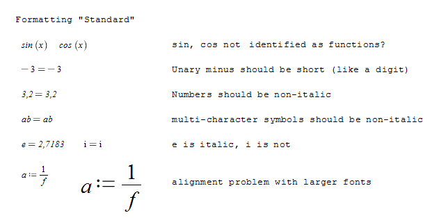

#4 Posted: 11/7/2017 7:37:32 PM
Thanks, Andrey. I already saw that the 80% only applies to subscripts.
What is the idea about keeping smath sheets consistent between users? The same document can have totally different appearance if the users have different formatting settings. If I scale the fonts up to keep them readable this might create overlapping regions if they were created with different settings.
Will there be a choice to make the settings being part of the document? Perhaps with the option that any other user can deliberately override it with his own settings. But then he is in charge for any mess created.
A short test showed the following issues (some of them might be matter of taste). I understand this is work in progress...
formatting.sm (5.5 KiB) downloaded 1543 time(s).
EDIT: The functions are deliberately set to italic in "Standard". Thus this can be fixed using a custom style.

#6 Posted: 11/7/2017 9:28:06 PM
I felt encouraged to play around a bit. I wonder why the font in math regions must be scaled to 120% to result in the same font size as in text regions of the same font.
Perhaps we are entering an era, where people become more picky about appearance issues of SMath sheets. The monospaced text regions become inappropriate now...

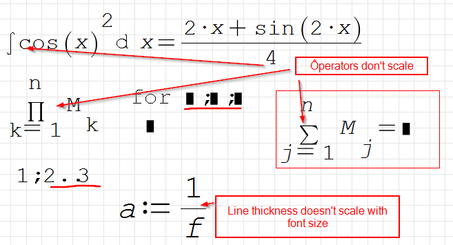

#11 Posted: 11/10/2017 7:51:02 AM
127 likes in 342 posts.
I encountered the following visualization problem in the use of vectorize (equations formatting: Default, Old Style, Standard)
[albumimg]1464[/albumimg]
Davide Carpi 11/10/2017 8:17:00 AM

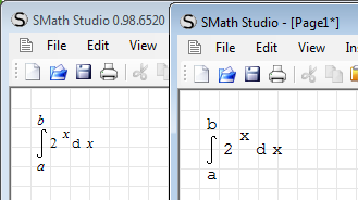

1,443 likes in 2,935 posts.
Seems that the boolean operator "greater than or equal to" is not drawn, unrelated to vectorize
I experience some horizontal misalignments (caret position, empty placeholders, ...), I am the only one?
frapuano 11/10/2017 10:02:00 AM, sergio 11/10/2017 8:42:00 AM

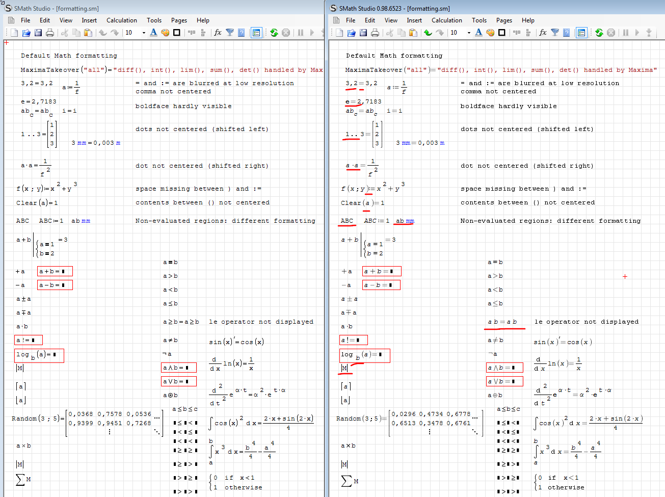

Impressive rate of progress!
At low resolution/small font size, the old formatting is easier to read, mainly due to the blur of the thin-lined operators.
Pasting multiple regions as image is nice.
When the maxima-plugin is downloaded from the gallery and the offer to search for Maxima is confirmed, then the setup dialog automatically closes instead of waiting for user input. The dialog can only be used after next start of SMath.
Feature proposal: pan the canvas by drag with the middle mouse button (as alternative to use the scrollbars)
formatting.sm (27.85 KiB) downloaded 1563 time(s).
#17 Posted: 11/10/2017 9:30:54 PM
Some issues with higher font sizes:
