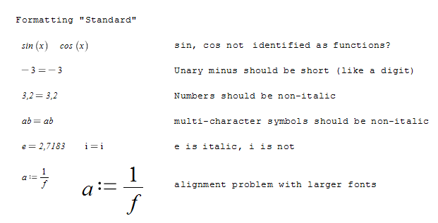

Thanks, Andrey. I already saw that the 80% only applies to subscripts.
What is the idea about keeping smath sheets consistent between users? The same document can have totally different appearance if the users have different formatting settings. If I scale the fonts up to keep them readable this might create overlapping regions if they were created with different settings.
Will there be a choice to make the settings being part of the document? Perhaps with the option that any other user can deliberately override it with his own settings. But then he is in charge for any mess created.
A short test showed the following issues (some of them might be matter of taste). I understand this is work in progress...
formatting.sm (5,5 КиБ) скачан 1544 раз(а).
EDIT: The functions are deliberately set to italic in "Standard". Thus this can be fixed using a custom style.

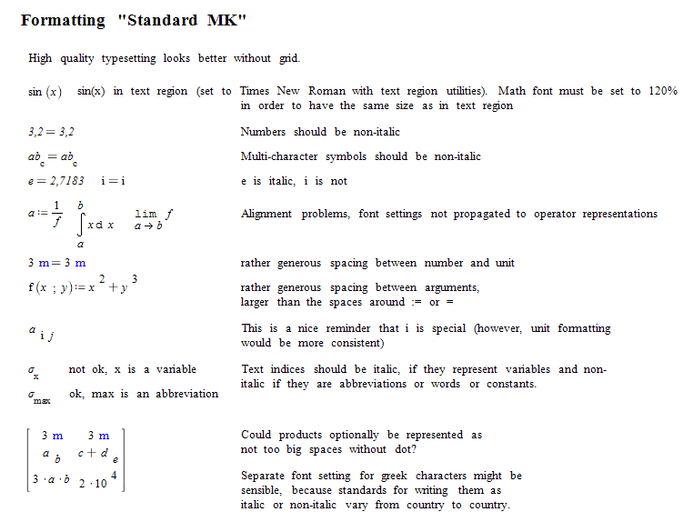

I felt encouraged to play around a bit. I wonder why the font in math regions must be scaled to 120% to result in the same font size as in text regions of the same font.
Perhaps we are entering an era, where people become more picky about appearance issues of SMath sheets. The monospaced text regions become inappropriate now...

formatting.sm (10,85 КиБ) скачан 1520 раз(а).

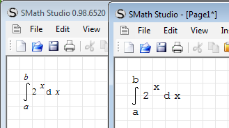

I encountered the following visualization problem in the use of vectorize (equations formatting: Default, Old Style, Standard)
[albumimg]1464[/albumimg]
Davide Carpi 10.11.2017 08:17:00
#12 Опубликовано: 10.11.2017 08:27:07

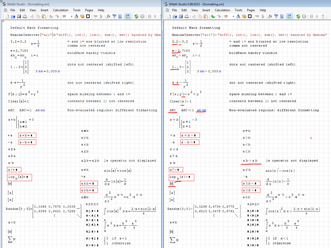

Seems that the boolean operator "greater than or equal to" is not drawn, unrelated to vectorize
I experience some horizontal misalignments (caret position, empty placeholders, ...), I am the only one?
frapuano 10.11.2017 10:02:00, sergio 10.11.2017 08:42:00

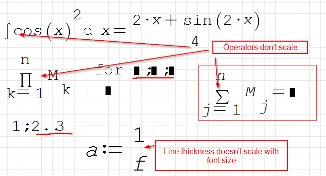

Some issues with higher font sizes:
