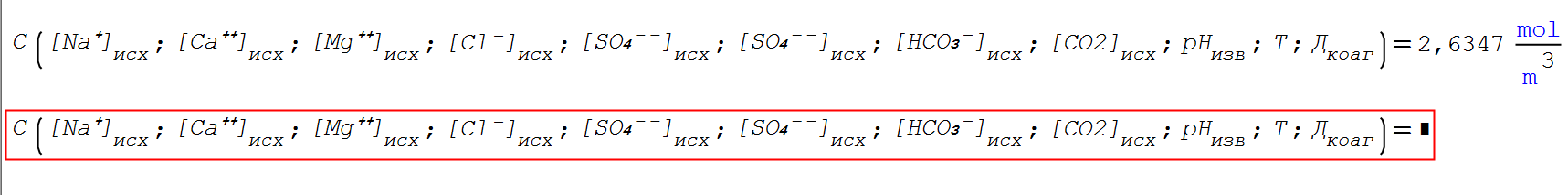

Why we have an error in this SM-sheet
Why we have an error in this SM-sheet - In Mathcad Prime all is OK - Messages

#2 Posted: 12/12/2023 10:47:04 PM
StvMath
StvMath
44 likes and 1 dislikes in 71 posts.
t is undefined. And why do you have [SO₄‾‾].исх as an argument twice?

I have corrected but new error message
Predochistka.sm (59.97 KiB) downloaded 1391 time(s).

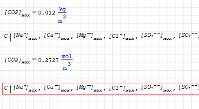

I call the function one more and get an error. Why?
Predochistka-Err.sm (62.61 KiB) downloaded 1398 time(s).
#7 Posted: 12/14/2023 6:47:46 PM

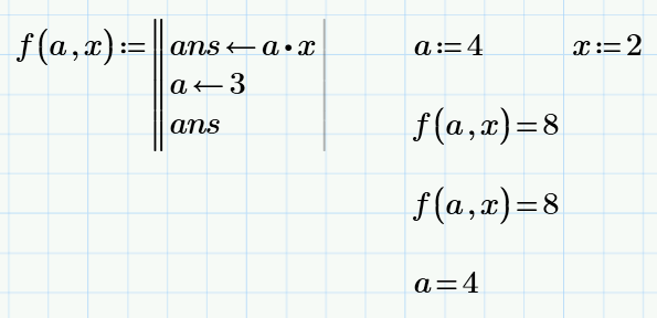

You redefine some function arguments inside the function body. That change its values globally:
See the green area in the document. Also, as an example:
Prime
