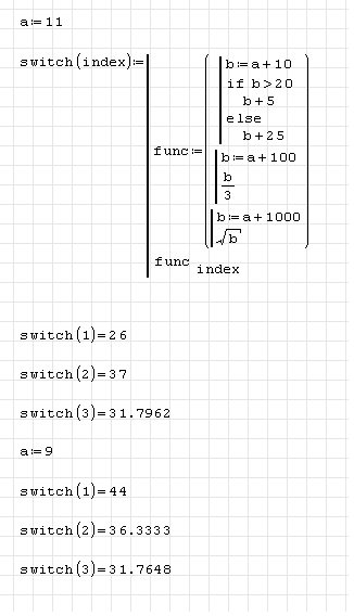

Here is a little trick I learned to simulate a switch statement. func is a matrix and the last statement is an element of the matrix.

#3 Posted: 9/12/2012 6:32:29 PM
Wrotew3b,
wonderful trick
