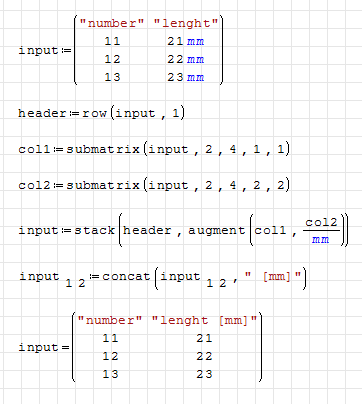

#4 Posted: 8/30/2012 7:57:37 PM
I don't know, but I can suggest you a compromise (see the attachments)
regards,
w3b5urf3r
P.S. here there is a little trick to automatize the unit replacingin in the attached script.

Hello w3b5urf3r,
thank you for your hint with the unitless output. I was so into calculation with units that I totaly forgot the old way ;-)
Mixed units inside a matrix would be even better, but this workaround works also.
