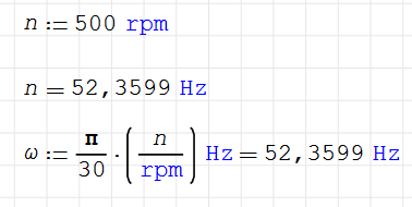

As you can see, Smath already stores "n" in Hz.
If you intend to convert manually then you have to do it correctly as shown here:

Thanks, it seems to work:
Is that the only possible workaround apart from not using units ?

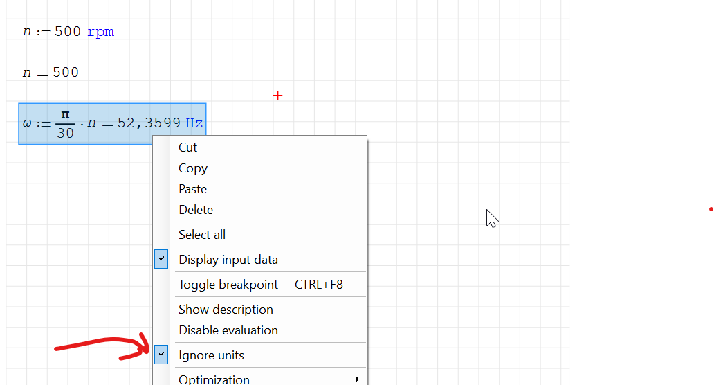

UnitaSilenziate.sm (2.88 KiB) downloaded 1276 time(s).

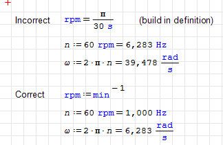

rpm is obviously wrongly defined in SMath.
The unit is revolutions per minute, not 2pi per minute.

SMath is wrong in that it displays angular velocity by default in Hz. Hz is not a unit for angular velocity but for frequency, meaning events per time. Whatever events are, for sure not an advane of 1 rad in angular position.
It would be better to at least display 1/s as a unit, which leaves it to the user to imply rad by 1.
It is also wrong that rpm is listed in the category "frequency" in the units selection dialog. Should be "angular velocity"
Both issues encourage the user to the wrong assumption that angular velocity is the same as frequency.

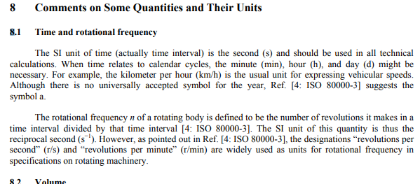

The NIST document (https://physics.nist.gov/cuu/pdf/sp811.pdf) defines rpm in chapter 8.1 as (rotational) frequency:
At the top of page 54, you will find the table caption
and further down the conversion factor.
Try to harmonize this with the Smath definition...

#19 Posted: 11/29/2021 8:43:10 PM
Nalorin
Nalorin
0 likes in 16 posts.
Nothing is wrong with rpm definition in smath, with respect to SI units.
According to SI and National Institute of Standards and Technology (NIST);
rpm is defined as revolution per minute, or rad/s, or (1047197xE-1 Hz).
Overlord, you've misread the NIST conversion table. As listed on page 54 and again on page 67 at https://physics.nist.gov/cuu/pdf/sp811.pdf:
The table says:
Quote
To convert from:
rpm
To
rad/s
Multiply by
1.047198E−01
Note that the NIST table does not convert rpm to Hz, it converts rpm to rad/s. I've laid out the calculations to prove it below:
1 rev = 360° = 1 cycle
π rad = 180° ==> 360° = 2π rad
So:
1 rev/s = 360°/s = 2π rad/s = 1 cycle/s = 1 Hz
Therefore:
1 rpm = 1 rev/min * (1 min)/(60 s) = 1/60 rev/s
1/60 rev/s = 1/60 cycle/s = 1/60 Hz
Or, using angular frequency, the NIST value is calculated:
1 rpm = 1/60 rev/s = 2π/60 rad/s = 0.1047 rad/s (matches the NIST table).
The easy way to tell if the calculation is right is by using the relation between frequency (f [Hz]) and angular frequency (ω [rad/s]):
ω=2πf
f=ω/(2π)
In other words, the angular frequency (in rad/s) is 2 pi times greater than the frequency (in Hz).
SMath erronously reports:
1 rev/s = 6.2832 Hz
1 rad/s = 1 Hz
1 rpm = 0.1047 Hz
1 radpm = 1 Hz
If I tried to use this kind of bad math in my engineering courses, I would have failed every one of my physics & mechanics courses!
The correct conversions should therefore be:
1 rev/s = 1 Hz
1 rad/s = 1/(2π) Hz = 0.1592 Hz
1 rpm = 1/60 Hz = 0.01667 Hz
1 radpm = 1/(120π) Hz = 0.002653 Hz
The SI Brochure (9ed) specifically warns against making this kind of error (Page #140 (page 26 of the PDF))
Quote
It is especially important to carefully distinguish frequencies from angular frequencies, because by definition their numerical values differ by a factor of 2π. Ignoring this fact may cause an error of 2π. Note that in some countries, frequency values are conventionally expressed using “cycle/s” or “cps” instead of the SI unit Hz, although "cycle" and "cps" are not units in the SI. Note also that it is common, although not recommended, to use the term frequency for quantities expressed in rad/s. Because of this, it is recommended that quantities called “frequency”, “angular frequency”, and “angular velocity” always be given explicit units of Hz or rad/s and not s−1.
IMPORTANT NOTE: That last line: "... explicit units of Hz or rad/s..." is NOT equating Hz and rad/s (i.e. 1 Hz = 1 rad/s). It is saying that a person needs to SPECIFY whether they are using frequency (Hz) OR angular frequency (rad/s), especially since both of these "frequencies" can be represented with units 1/s, since radians are dimensionless:
1 [rad] = (Circumferential path segment that is the same length as the radius)/(Radius) = [m]/[m] = [unitless]
QED.
