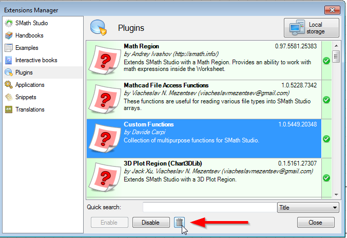

Seems you have some outdated plugins.
Go to Tools > Plugins and try to uninstall every custom plugin.
If this option is not available in your SMath Studio:
  • Close your SMath Studio
  • copy & paste %APPDATA%\SMath\extensions\plugins in the search field of your start menu and press enter
  • delete eveything in that folder
  • open SMath and download again the plugins you need
